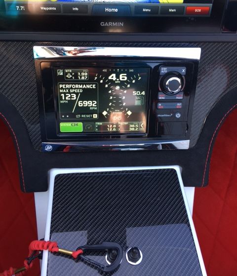

Another great pull with the Merc CNC 33" and 50 Gallons of fuel.

That's awesome Daren! Looks like Mercury is still under-rating the pitch on their big cleavers. Those numbers equate to less than 1% slip - which we all know is impossible. Merc cleavers are typically rated approximately 1" less pitch than they actually are - at least that's what I've found with my experience with them. The Merc 16.5" x 35" 5 blades I ran on my 30 went 156mph @ 6,200 w/ a 1.34 gear - which only computes out to 153mph. Yet the 16.5" x 37" 5 blade Herings I had went 158 @ 6,600rpm - which computes out to 8% slip. I just came to the conclusion that Merc cleavers were under-rated about 1" and Herings were over-rated about 1". And this wasn't based on just one set of Mercs and one set of Herings - I had two sets of each on my 30 at some point over the course of owning it, and they all seemed to be the same as far as pitch rating went. Hurry up and get those Dewald 35s on there will ya, I'd love to hear how they run! It seems like those Merc 33s could possibly get you that elusive 125 mark if you ran it empty on fuel on a cool day.

That is great to see Darren. Are those props 15 1/4" or 15" in diameter?
Would love to try a set of 31's on my boat.
The prop shop Frank and Jimmies down here has a machine that can check the pitch of each blade. Since you are racing with Gary Ballough FJ Propellors you should have them check them out. It would be interesting to see if what Dale says is true with them. If so sure would make them look very good.
