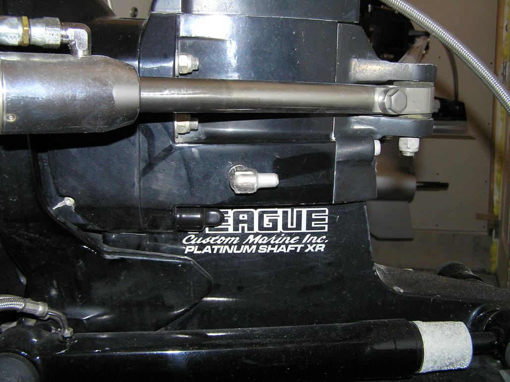

On the side of the upper case there is a fitting that is screwed into the case that points backward? The fitting is threaded into the case and is open on the other end? Does anyone know what this could be for? Note that the drive pickups are not used since I have separate water pickups on the hull but the drives still have the water pickup holes in the lower case.

Probably for the water speedo tube.
Clustergear 03-16-2009 01:00 PM
Does it look like someome drilled hole to direct water from stock pick up to use as drive shower
Boater8987 03-16-2009 01:08 PM
Maybe- Water still needs to circulate thru the drive for cooling of the oil and that fitting would be the water outlet?
Mr Gadgets 03-16-2009 07:37 PM
Water does need to flow thru the drive to cool it!!! On a transom pickup boat, that is one of the techniques to keep water flowing. You can also put a fitting on it so that it points at the side of the case above the water jacket, or put a pipe over the top or around the back with holes in it to spray on the upper case.. the more the merrier!!
Hope that helps.
Dick

stormbauer 03-20-2009 07:51 PM
2 Attachment(s)
See pictures
[ATTACH]Attachment 379666[/ATTACH]
Griff 03-21-2009 02:55 AM
1 Attachment(s)
That fitting is tapped right into the water jacket on the drive. It is either for an old drive shower feed or is the dump for the water that goes into the drive. I had my drive shower on my Pantera fed from that exact spot. I had a hull p/u for the engine. I also had a dump on the side of the boat where water coming in the drive would dump overboard.
