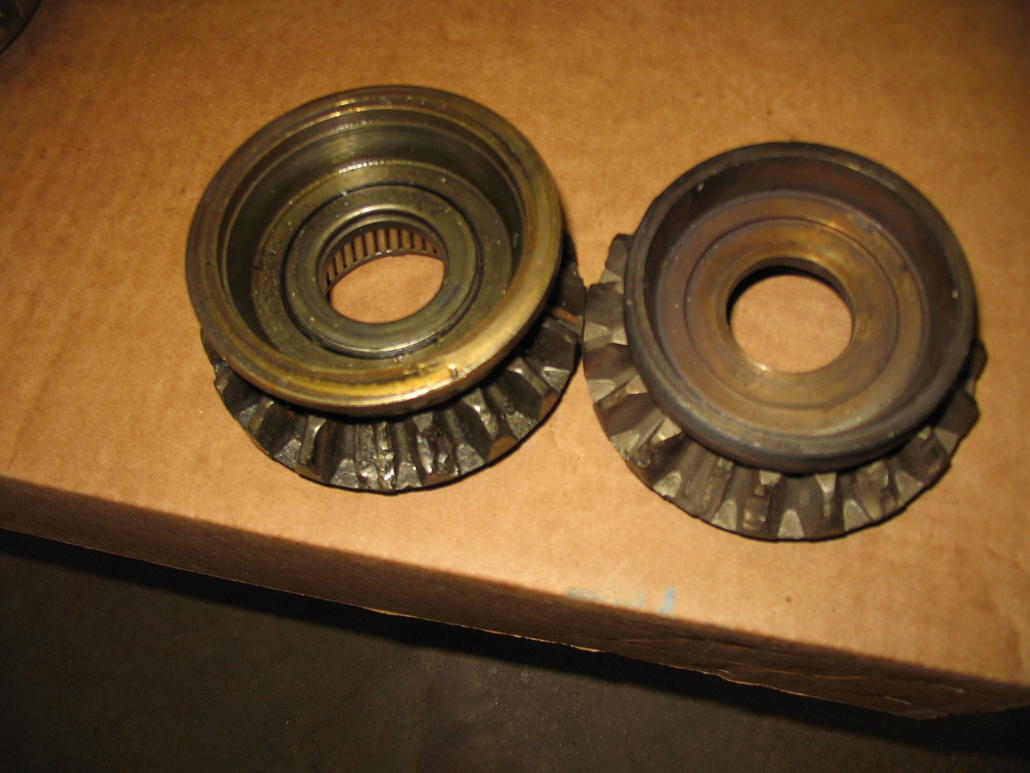

Here's a couple of XR driven gears from my scrap collection
Didnt hit anything.....they're just junk....both wiped out the case too.
Attached Thumbnails Broken upper gears from hitting something?-broken-teeth.jpg
