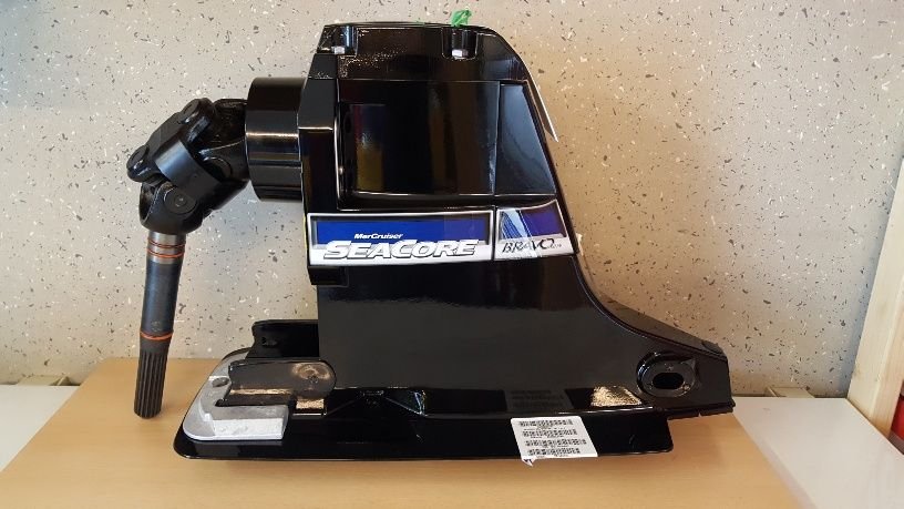

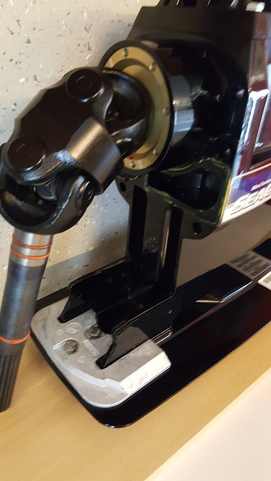

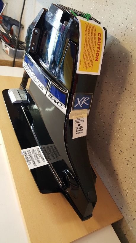

At Bravo anf much HP it would use driveguardian!
I am sorry that i am in germany,as i have an new from merc XR Sweptback Upper for sale for 3900 $.
Seacore version and with gurantee from merc.
Also a complett drive from it!
If someone have idea to shipp easy,this let me know!
I use now DG by myself. Michael
