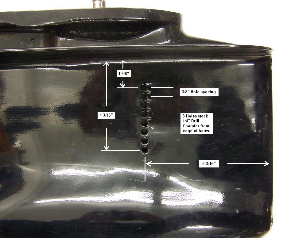

Want to convert a LWP lower to DWP. Any helpful hints on doing this mod correctly?

Looks like I can't edit my post or upload pics to a new post. Shoot me an email and I can send you a pic with the dimensions for where to drill the holes.

Ok.. just doesn't work in IE11. Let me see if I can post the picture..
[ATTACH=CONFIG]560615[/ATTACH]
Looks like Chrome is the answer!
Now you can add as many side holes as you like. The more you add, then you could block some of the lower slots. On the DWP case there are 5 small holes in the nose and the side holes. On the LWP there are large slots. So a balance could be found to accomplish what you want to do.
Hope that helps.
Dick

Thanks Mr. G.
