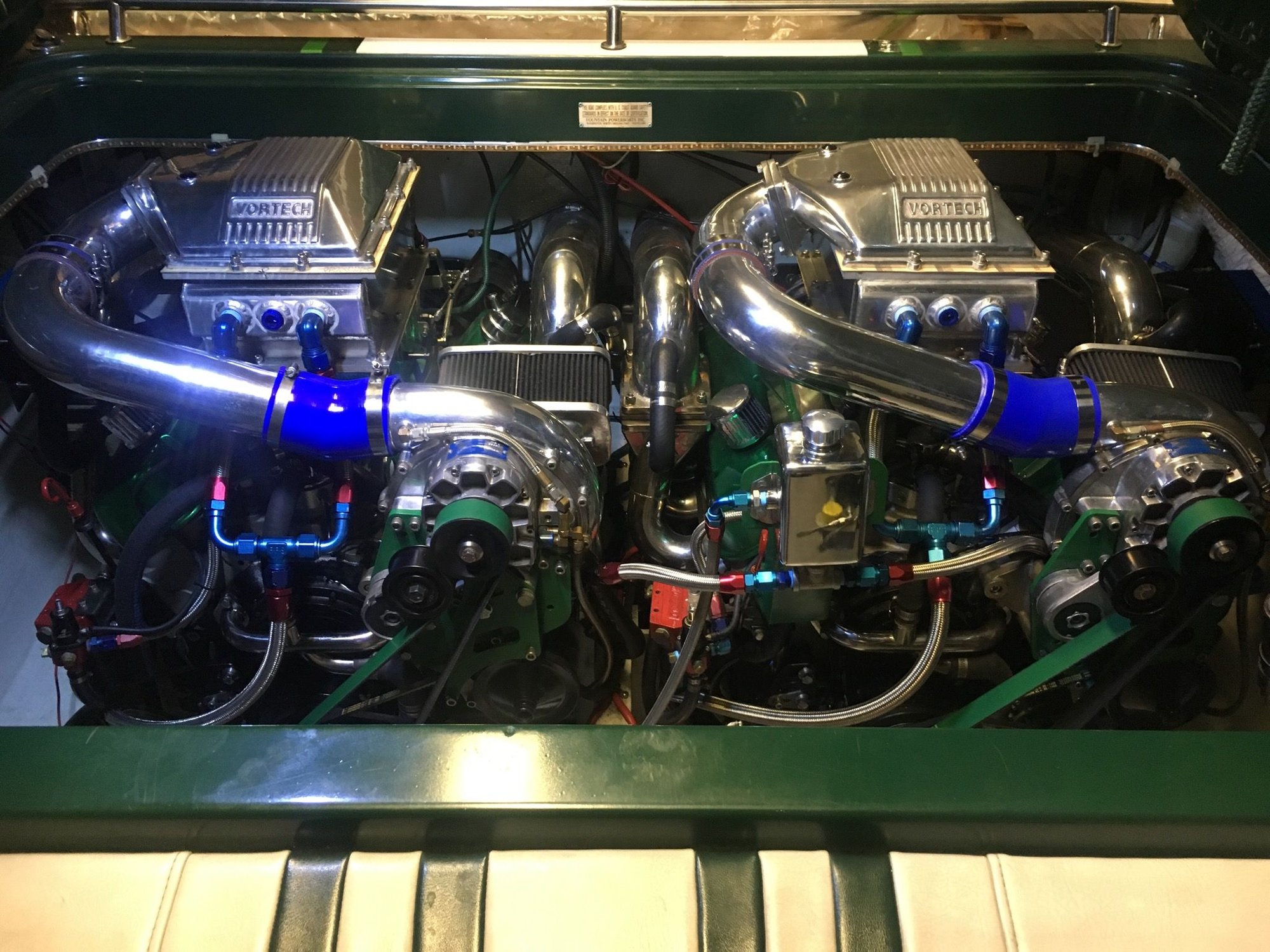

I have a 35 straight bottom fountain with 517's and centrifugal super chargers they make around 775hp

^^^ Very nice. How do the Arnesons handle in big water?
No problem I can hold it wide open all I want , I have not broken anything in the drives so far .

Real good info guys! Were your speed gains with just bravo/Arneson swap, or was there some HP added too? Also, being that the motors had to be mounted a little lower, did that effect how your exhaust lines up? And one more question, being that these have a transmission, do they shift smoother in and out of gear, like a TRS?
I added wedges to my exhaust and used my existing holes . With the transmissions they shift in and out of gear a lot smoother than the bravos .
