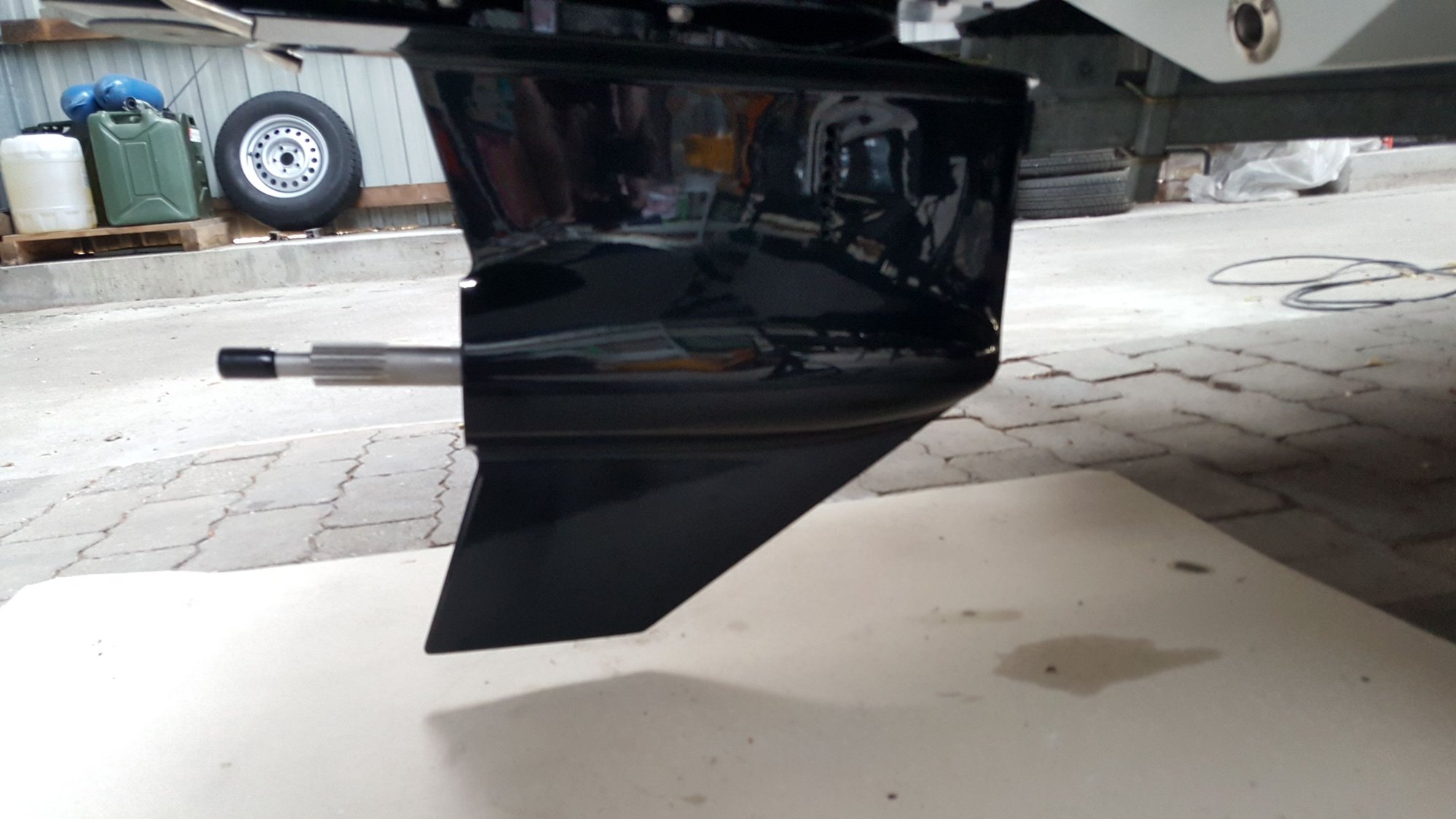

The kav plate from my drive is nearly a bit under the hull from my Baja 275, when it is a bit trimmed!I think this is very deep and so i try next season an -2 sportmaster!

That drive is way to deep - when you trim your drive up the front of the cavitation plate actually goes down into the water coming from under your boat. This pulls the transom down.
I would go with a -3 IMCO drive and I wouldn't be surprised if you gained 10 MPH. Your handling should improve also. You will have to modify the back of the upper for 1/2 inch prop clearance IF you don't buy a complete drive. My first boat had the drive mounted that low and I gained 10 MPH just by going up 2 inches. I later installed an Alpha SS drive that is 2 1/2 inches shorter and gained another 10 MPH. 18 ft Glastron Carlson CVX 18 with over 500 HP and Alpha SS - mid 90's

Boat runs now max 80mls +- and i am happy if i gain anything like 5 mls because i think also that baja mount the drives very low in the 275! the Outlaw models have the transom all higher!
I have new upper and build an -2 sporty that gets new gears,seals and a nice podercoating!!
Cant await the new season as i also mount an addon from mayfair!
Thanks!
Michael
New Powdercoated!
