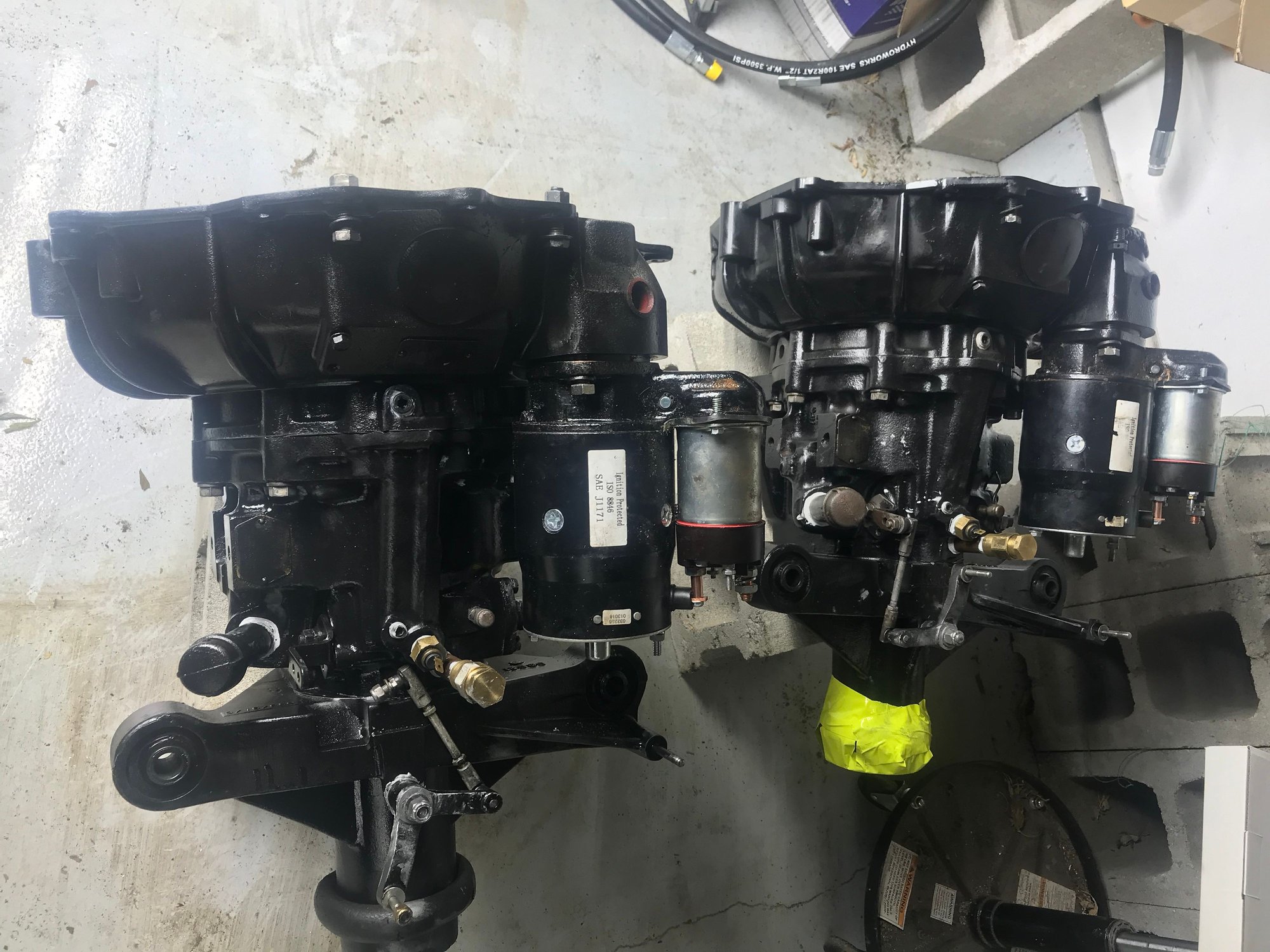

I have two 10-17 velvet drives. Looking to beef them up. In high school I rebuilt 7 turbo 400 transmissions. My hunch is these Borg velvet drives would be pretty easy to rebuild compared with a turbo 400 transmission. Any thoughts? The rebuild kit is about $200. What is the weak link in these drives? I’ve read adding more clutch plates helps.
who is best for such a rebuild?
im told 10-18 drives are stronger? Are the 10-18s a direct replacement. TRS outdrives on my 1986 30 foot twin checkmate
your thoughts would be greatly appreciated.

there is a difference in overall length. if i remember it was about 3/4 inch different in length. i broke the c-71's in 33 scarab, replace it with c -72.
they can make a c-71 into a c-72
my now 38 scarab has had c 72s,,trs,, since made ,,1989,,boat has had 600 hp motors for last 25 years.
now i have about 700 hp....

Both all rebuilt. Just like new. Anyone need 2 of these. I’m upgrading to 1018s Have 2 coming I bought off eBay to rebuild
