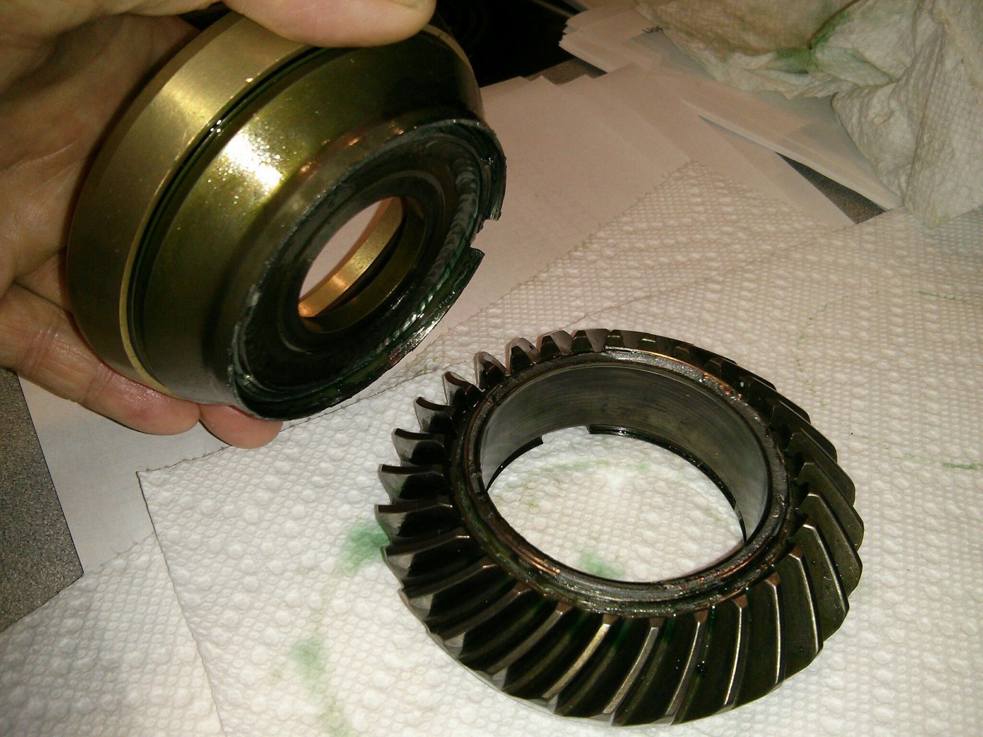

More than Likely this is what you will find ..... got a whole box of em .....

I had the same issue with my boat on the 4th. No forward but reverse worked. it ended up being the upper thrust bearing had been completely chewed up! Which took out the upper gear, clutch shaft and all the bearings. Lucky for me, I had a new gearset, clutch shaft and bearings, and I wasn't only down a few days.
Have you torn into yours yet to see what the issue was?
