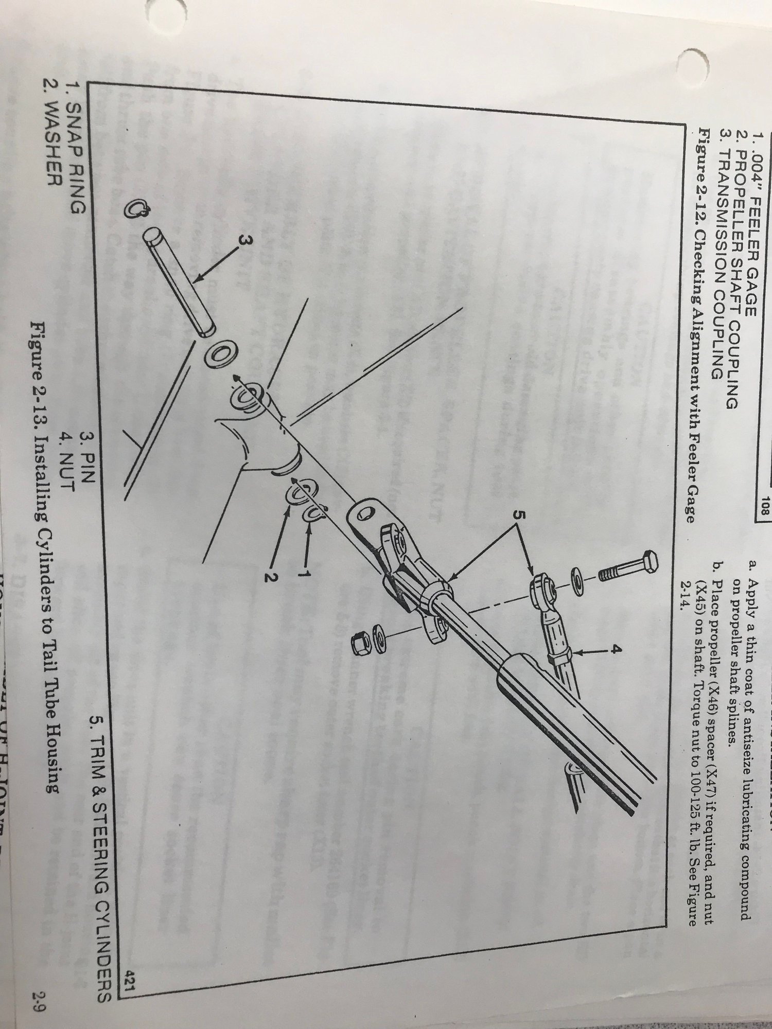

Well I have drawings of everything, except an exploded view of the trim cylinders ha!
this is the closest I have

lol, thanks it all helps. No idea how many times its been apart prior to now, and if was reassembled correctly!
Thanks again Jason
