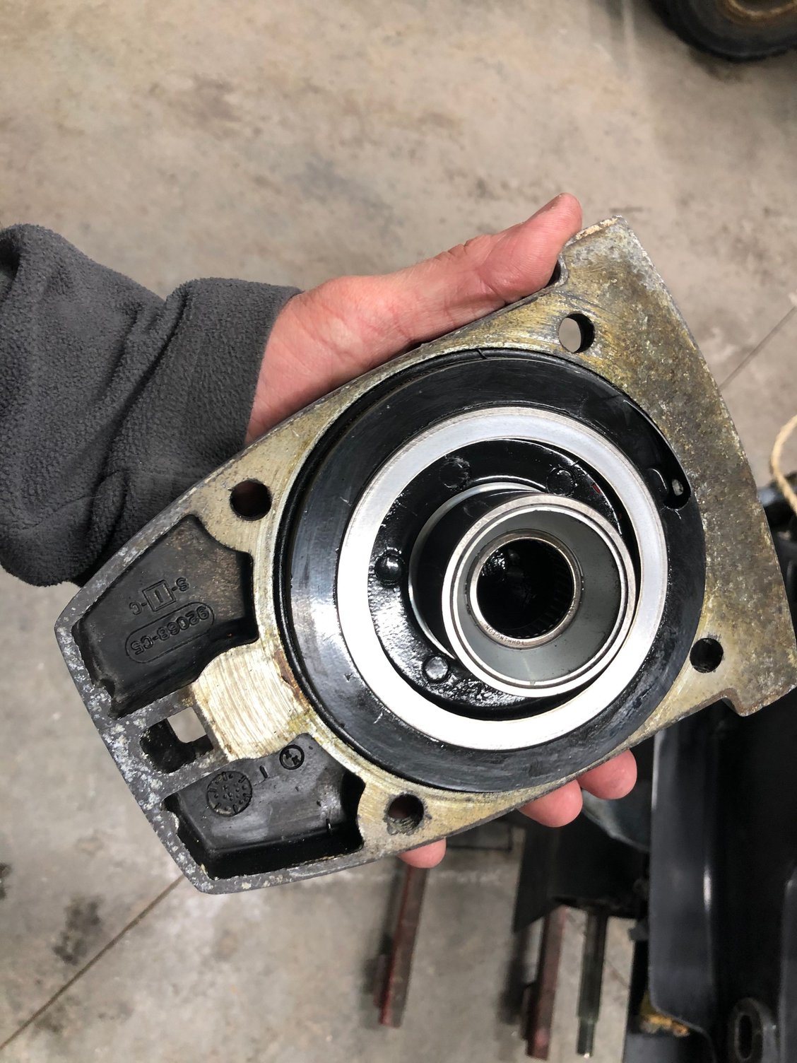

Had some minor corrosion so took it off
any sealant that needs to be used or the oring get the job done alone?
and how tight do we screw the cap in?

Need some polishing/smoothing on those surfaces where O-ring and seal surfaces
Before it goes back together, have you removed the back cap to inspect?

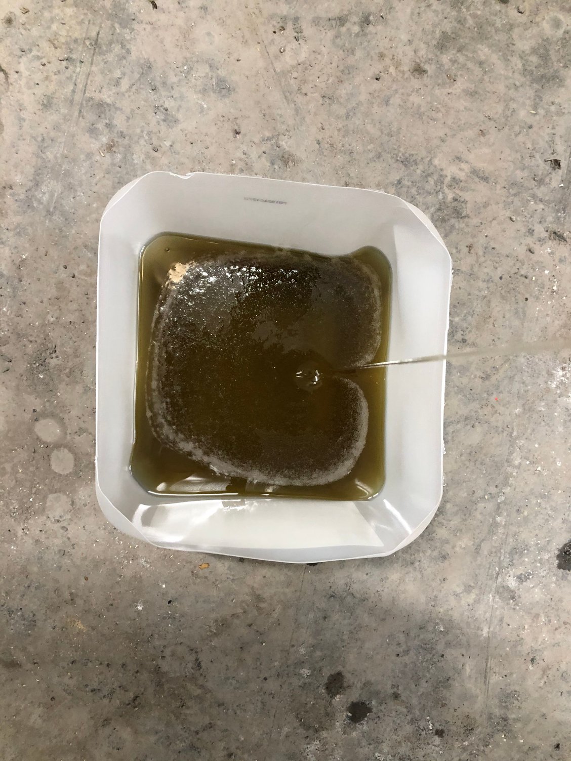

no i did not... nothing on the magnet when removed to drop oil so... should I really?
It cost nothing to remove, but there might be some leakage there, and could advise of future issues. Same torque spec
