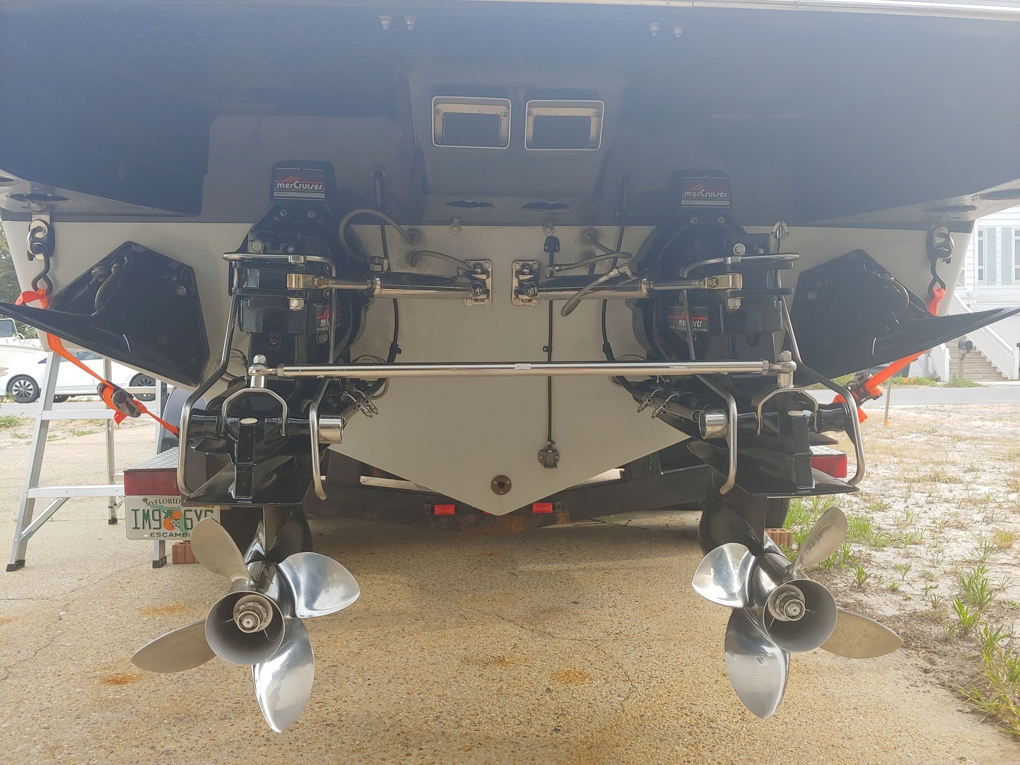

Ps- the boat is in its lift/boathouse for the long Florida season, so I am trying to do this myself while it is hanging there (without trailering it to a service center). Picture for reference

The drives look newer
Do you have a lube bottle?
AllDodge is offline

I believe the drives are original to the boat (maybe previous owners on this forum will chime in)...but I do not THINK I have a remote reservoir...can you attach a picture of what it would look like and where it might be in a Formula 311?

if you have them, plastic square bottle with a screw off lid, setting in a metal housing, could be mounted on the transom or engine, your boat looks real clean for a 88

If that is an original 1988 Bravo it will have a dipstick in the top cover. In 1989 the lube bottle was introduced

I love this forum! I am busting my butt to keep it nice. I have Latham steering, K280s, etc...so I will look for what you pictured...Thanks!
Here is my engine bay...(can you see any reservoirs?)
