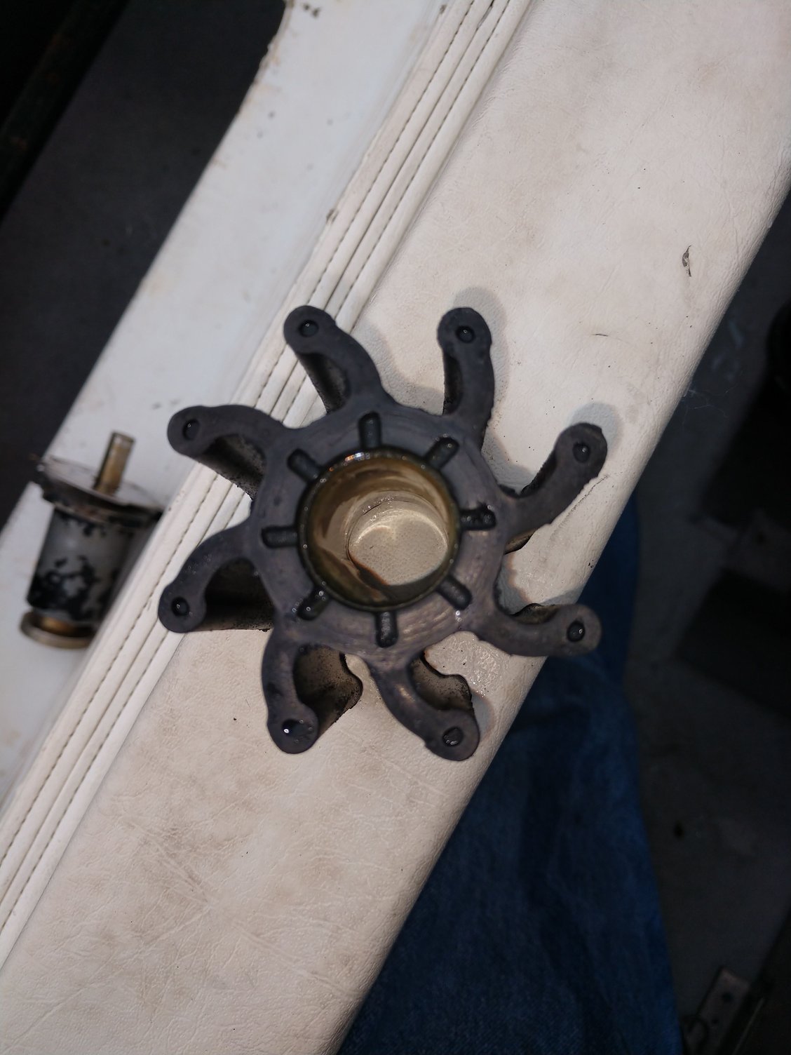

New one to me. Engine over heated while on the hose. Never an issue before. Impeller is fine. While intake hose was off the pump I turned the water on and nothing came out. Took the intake hose off and still nothing. But water will flow out thru the transom. Just not in. So I pulled out drive. Put muffs back on. Water came out. Drive was hanging nose down so I leveled it out and water stopped going thru it. Anyone seen anything like this before?
Draining the gear oil over night. Will drop the lower in the morning to see if I can find what's blocking the flow. Kind of wondering if wasps built a nest in it since last outing two weeks ago.

No, the drive was all the way down the entire time. I'm not sure how the impeller was still in good condition either. Unless there was just enough water getting thru to provide lubrication at that point in the system. It has a little bit of set from being in all season but it has plenty of tension.

Try a different impeller the hub could be spun out that happened to me two times

That housing looks pretty rough also. May be put in a impeller and housing.

Mystery solved. Mud daubers had crawled in the water holes and built nests in the water passage.
Plus I'll address the sea pump since it's all apart. Was planning on another few outings. But since I've lost this weekend to freaking wasps I have the time before next weekend. I'll back flush the oil cooler too just in case some of the mud nests made it that far.
