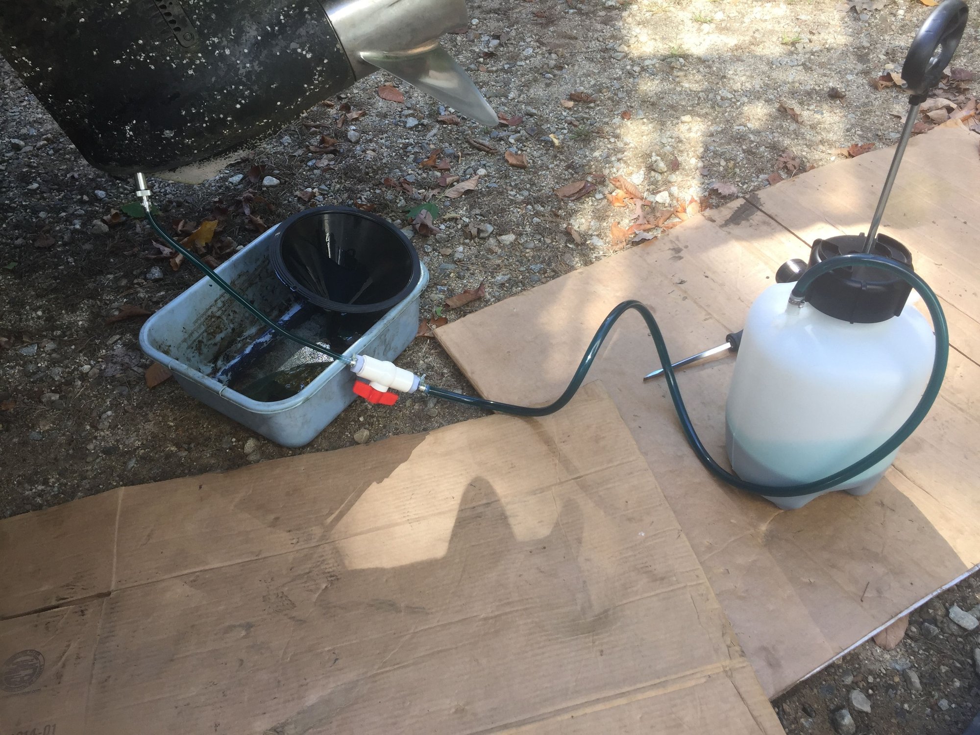

Finally put together the set up with bigger lines. Fill faster, but maybe 30-40% faster. Cost close to $70 or so vs $30 or so normal sprayer, when all said and done with fitting and etc.
Here’s a pic

Btw: that customer wasn't interested in having a skeg. Lololol
very stable in corners and high speeds...................
