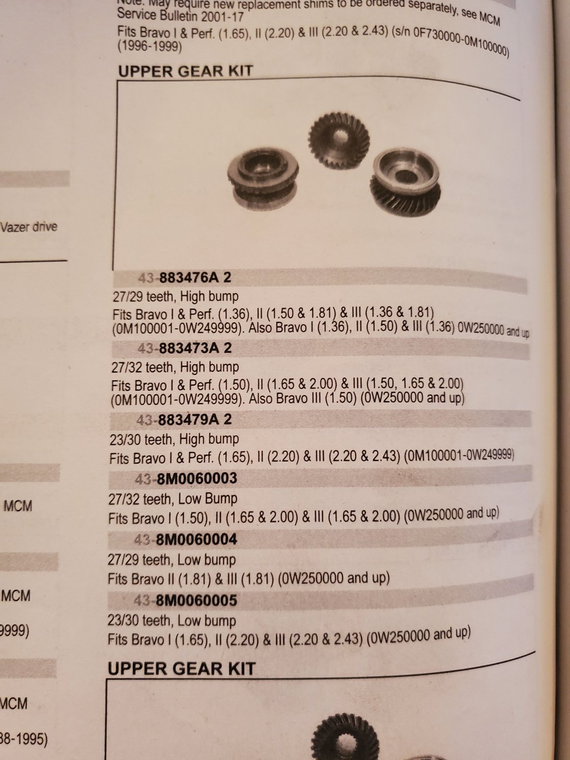

hi everyone, i'm looking to know how to differentiate low bump from high bump gear someone could guide me on that thank you

As I recall, the high bumps will have H on the eccentric ( bump ) ring
right near the + - markings. X and XR gears are high bumps, only std bravo’s
list it as being optional

It really doesn’t have anything to do with the gears, they just thread on to them
Mercury doesn’t even sell them separately, but others do
https://www.cpperformance.com/p-1682...hift-ring.aspx
Their primary function is to hammer ( by the cam action of the rotating ring)the shift fork and cone out of the driven gear, when shifting out of gear, they do to a lesser extent, help it shift into gear, there’s also a more robust shift link set up used with the high bumps due to the heavier load they experience

Keith Atlanta and bajaman, I may have misspoken in my question but look at this photo and read it carefully and you will see know from the quicksilver marine parts
