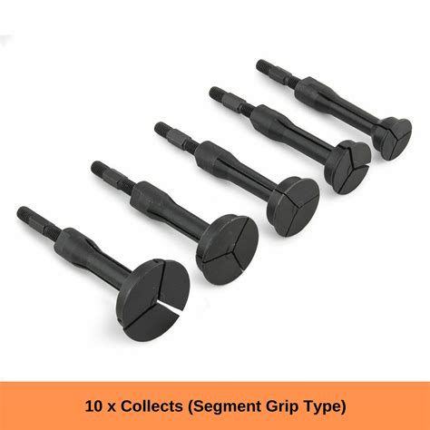

If you’re wanting to reuse them, you need something like this
Mercury doesn’t sell this bearing, IMCO and Bravo shop do however
