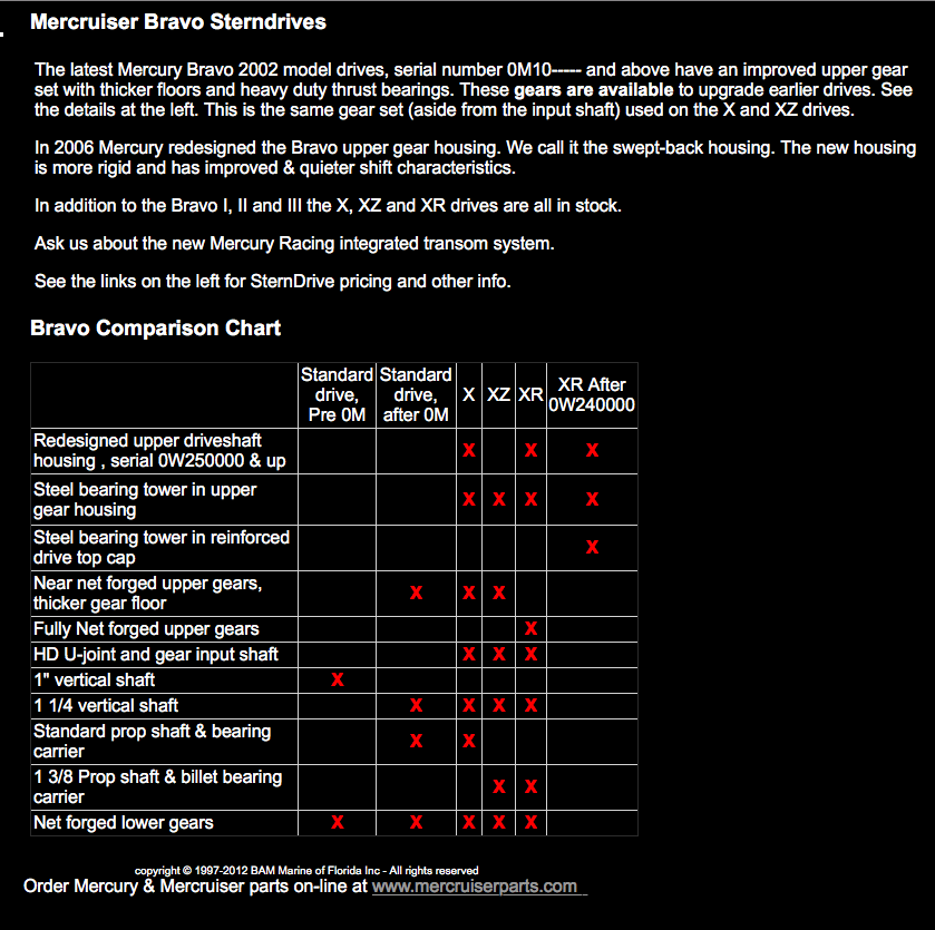

What is they difference between bravo 1 and bravo 1X ???
30ftpanther is offline
Found this.
I remember seeing it on this site awhile ago.
Came across it on another site.
Originally on Bam's site. Couldn't find it there.
cheech is offline

Originally Posted by cheech
Found this.
Thanks for the information!

Originally Posted by Griff
Regular Bravos used to come standard on power up to 600SCs. In the early 2000’s the failure rate seemed to increase behind the 496HO’s so Merc came out with the XZ and XR and the X
Griff,
So, I'm a bit confused....
It sounds like you're saying the durability of the B1 diminished in the early 2000's, and Merc's solution was to develop several stages of stronger outdrives. But the chart shows a different story. I *THINK*. The drive on our PQ is a B1, MFRd in 2001. I'm just trying to figure out what we've got.
Thanks. Brad.
(937)545-8991
