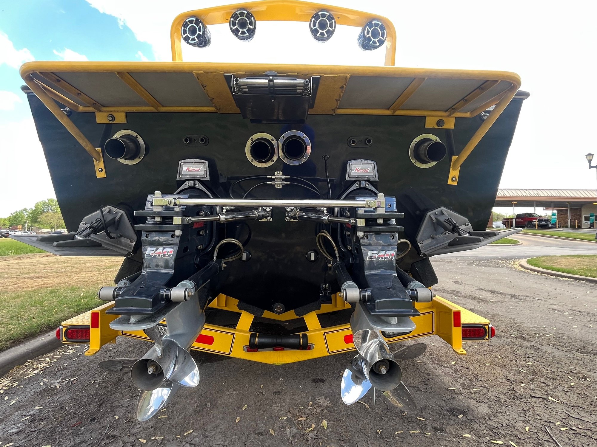

87 Chris craft stinger 390 X. Owner replaced
the original TRS drives with Konrad's and injected 540s. I'm assuming in the stock location. The boat comes out of the hole OK but appears to be cavitating until it is up on a plane. My initial thought is the drives are not far enough down in the water. Thoughts?

Those appear to be Konrad HP’s, they’re just under 2” shorter than the
TRS, this may happen when getting on plane, it’s a trade off for better performance at top end.

Oh I see. So I'm assuming with powerboats this would be considered normal? My first thought was it needs bigger props but I don't think they could be more than an inch and a half longer blades.

There is nothing wrong with a little cavi when getting on plane, mine break loose around 3500 just pull the sticks back a bit and they'll bite

My boat had the propshafts 3” below the bottom of the boat.
They key to getting it on plane was to not exceed 3200 rpm’s, if you did,
it would blow out and you would have to let off and let it get hooked back up, or start over, if you kept it below 3200 rpm, it came on plane every time.
You might want to try and figure out if you have a particular rpm on yours
where this occurs
