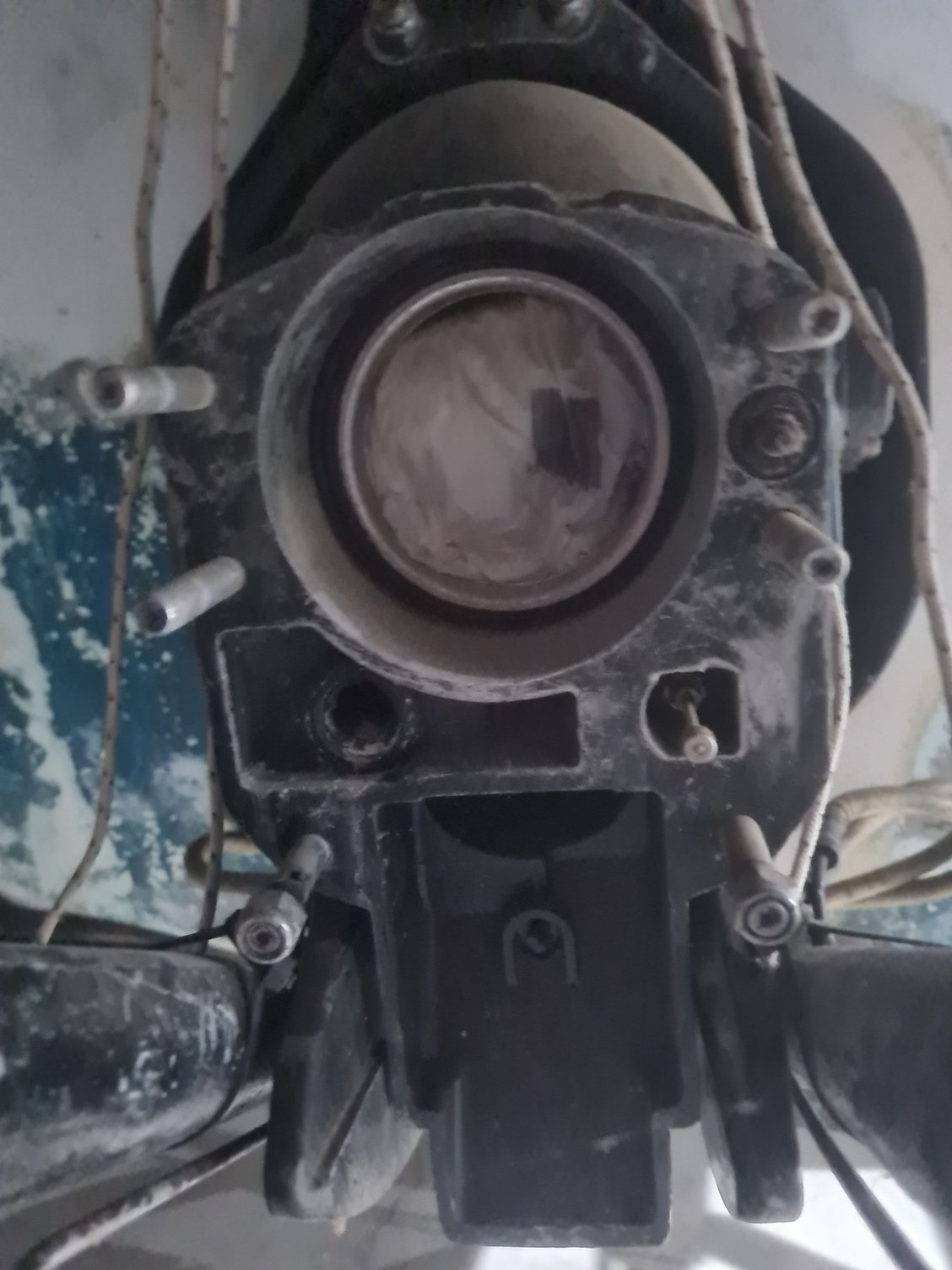

I find a sterndrive bravo 1 with serial number 0D535460 with 1,36 ratio. Can someone find the year model of this; This drive is for big teeth at gear?

ODxxxxx is an early 90's Bravo 1. That picture looks like to top cap has been off and not put back on and sealed. Offer them $50.00 US to take it off their hands. probably needs to be totally rebuilt.

Do you have a Bravo transom assembly on your boat????

Yes I have, here is a photo of this.
I forgot to tell you that for the above sterndrive they were selling it for €2500.

That’s a bravo transom assembly, that will work with the drive in the picture you posted

Looks like a standart Bravo and fits to your transom. This drive have no Big teeth, all standart. Propshaft only 1" and you can see the oil under the propshaft, looks like the propshaft seal are damaged. Topcap are open so you can look to the bearing race and the oil. Than open the rear cap and look to the teeth and make pictures.
