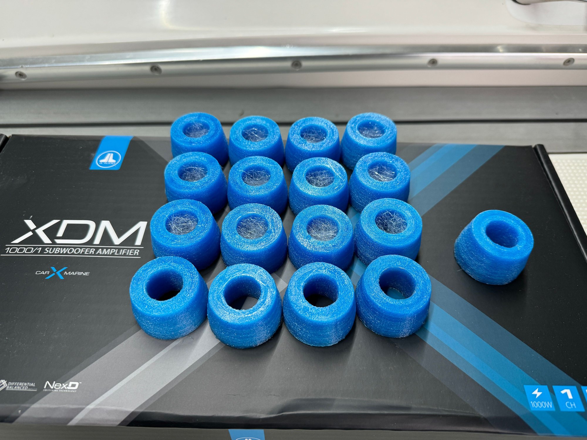

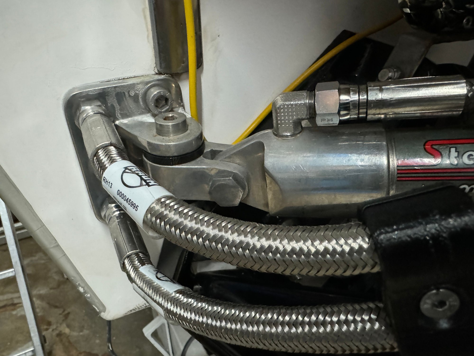

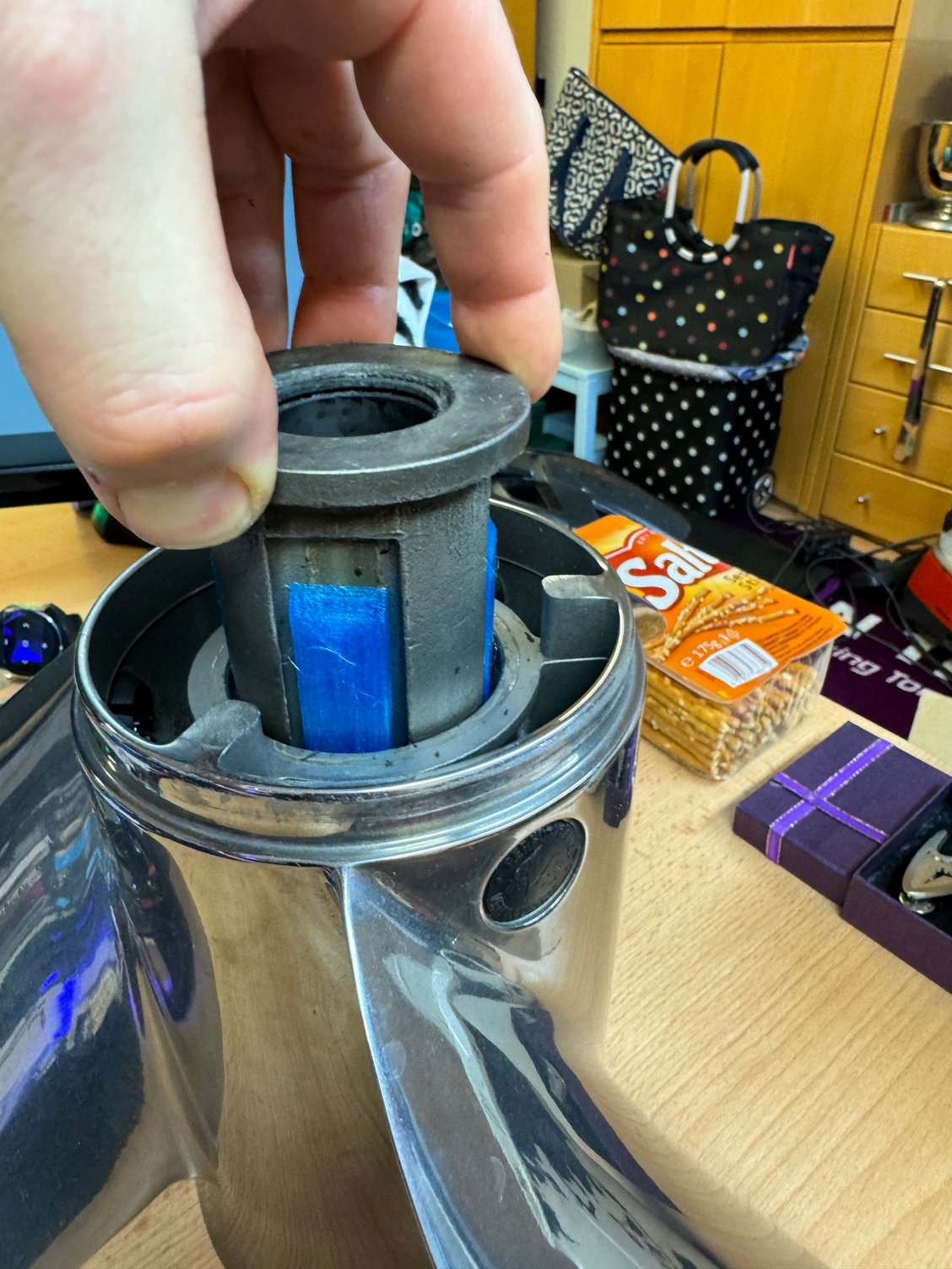

I printed some pushings in TPU95 and i used it this year with no problems. i printet with 10walls and 100% infill. Trim Zylinder (i used the Hardin "red one" but the are harder than the first mercruiser black one but softer than the new mercruiser black ones) the my blue version are same than the new black mercruiser but fit without play, HP Prop Hub (are made for the 4 plastik stribes that fall off most times, now the stay on the hub and sliping in and out perfectly), Imco Steering Ram Pushings and for the hydraulik hose i used PET-g clamps,

That printed hub bushing is pretty slick! Have you had any issues with vibration or anything similar?

no problem, nothing.
i can email the file and if you have a 3d printer ore you have somebody with one, you can print it and test it.

Thanks, but I do not have a printer. Been out of that line of work for 8 years now. I actually run the round bushing hubs. I keep getting a vibration coming off plane and considering switching hubs to see if that cures the vibration. I even bought some O-rings and cut my own bushings but that did not eliminate the issue.
