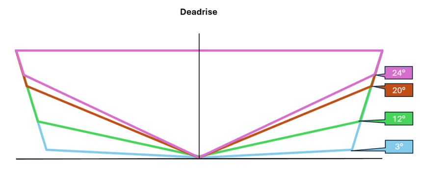

Take a screen grab or convert your plans to a jpg and then post.
Tunnels behave a bit like a jet system. A shrouded prop at the very least.
A 44° deadrise means your hull has almost a 90° vee. Not great for lift, shallow running, or stability. Maybe it was a typo?
Are you proposing your prop tunnel location where the delta pad would be?
Let's see some pics.
