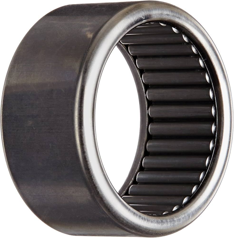

Does it look like this one?

yep, full roller without cage
