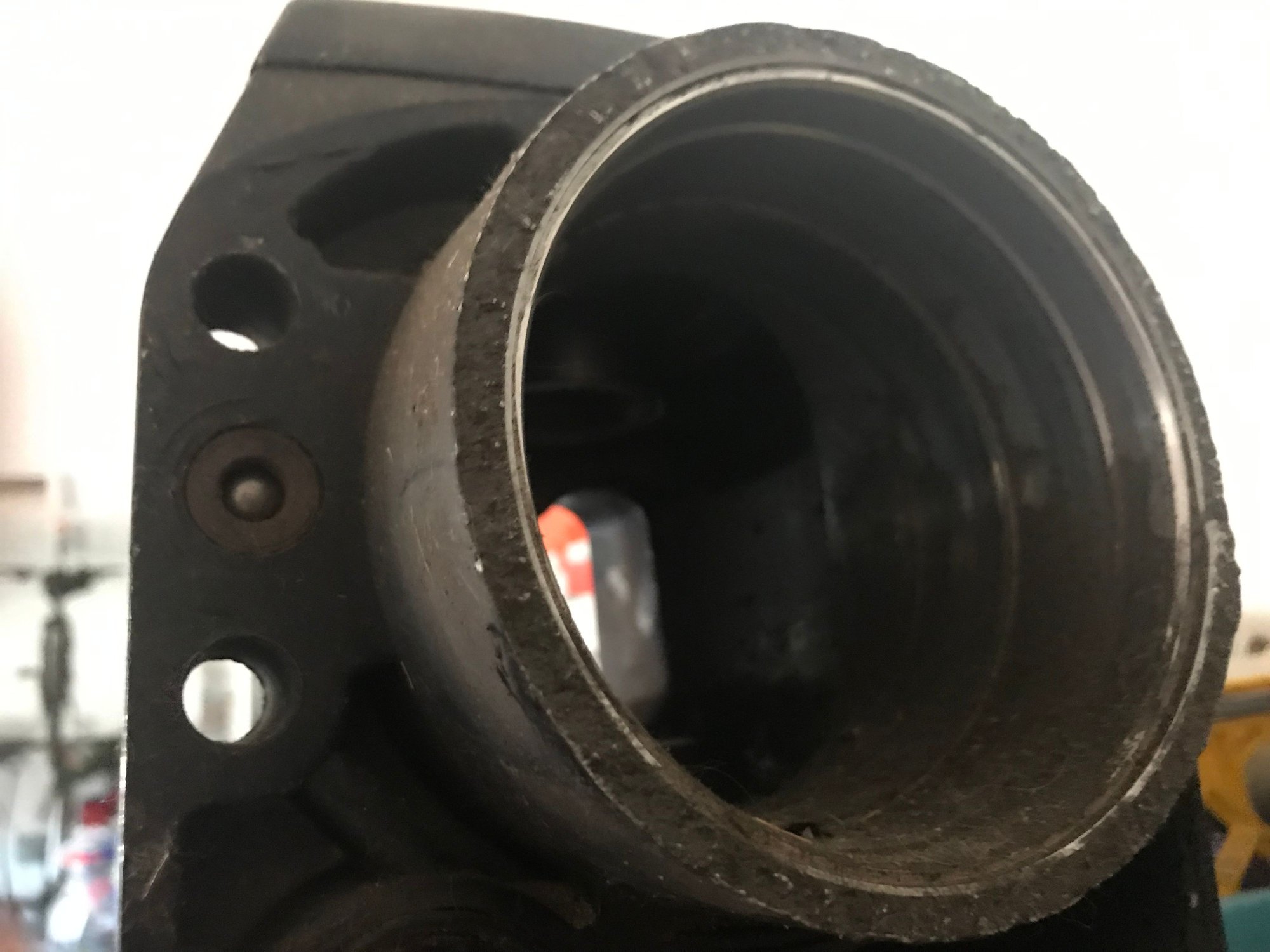

Hello
I need technical assistance with replacing this spare part in a Bravo XR upper housing, part number 2 in the image. Unfortunately, I don’t know the name of the part, but I’m planning to replace it as a preventative measure before it becomes a problem.
I’ll also be replacing bearing number 7.
What is part number 6 and do I need this one too?
There is a newly manufactured aftermarket part available from Bravoshop, but it requires also purchasing and installing their custom-made shaft and bearing.
However, they do offer better-condition used part number 2 for sale, which is what I’m planning to go with.
Has anyone done this before and can offer some guidance?
The part is supposed to be threaded into the housing with thread locker, and I’ve heard it can be a real pain to remove — there’s a risk of damaging the threads.
Any advice would be greatly appreciated.
Thanks

I believe # 2 is the steel tower ? and I think it screws in
https://www.hardin-marine.com/c-1828...ive-gears.aspx
Yes you seem to be absolutely right.
But I wonder if it’s just a plain/sleeve bearing on the outside of the tower #6 in the picture, and one needle bearing on the inside #7 in the picture on inside and outside of the steel tower.
If so, you only should have to change the plain/sleeve bearing?
I don’t have the XR right now in front of me so I can’t look at it. It will come with a boat I’m going to by so I need to fix it

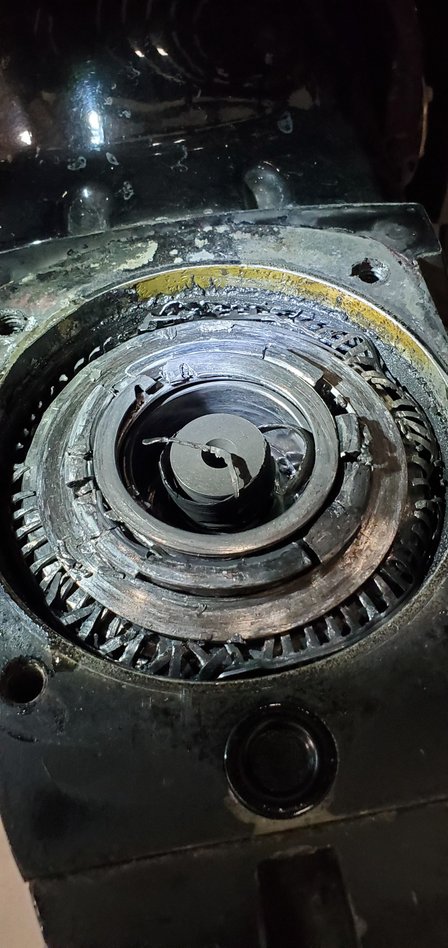

I grenaded a upper end of last season so bad it tore the tower out of the housing............
Yes I saw a video on YouTube where max machine showed a grenaded upper and, good videos.. but didn’t look fun

I’vehad a tower shear off in a std bravo case (which are not the steel tower) but every time on a X case that I’ve dealt with( when a gear tooth breaks off and tries to swim between the drive and the driven gears, this happens
