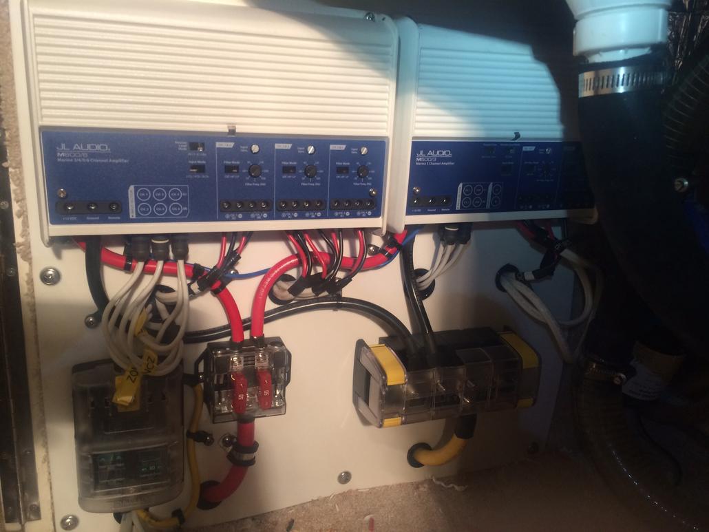

sorry for the hijack, but this info could be helpful to OP..
picture of my amp wiring below...
