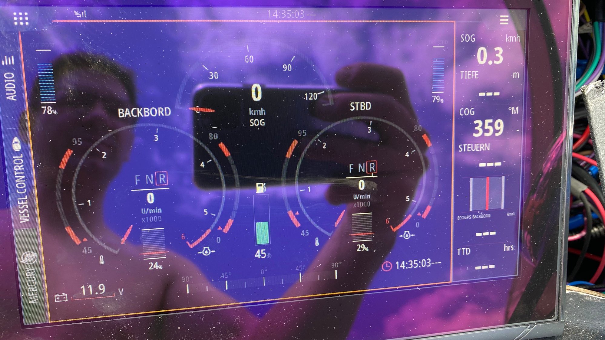

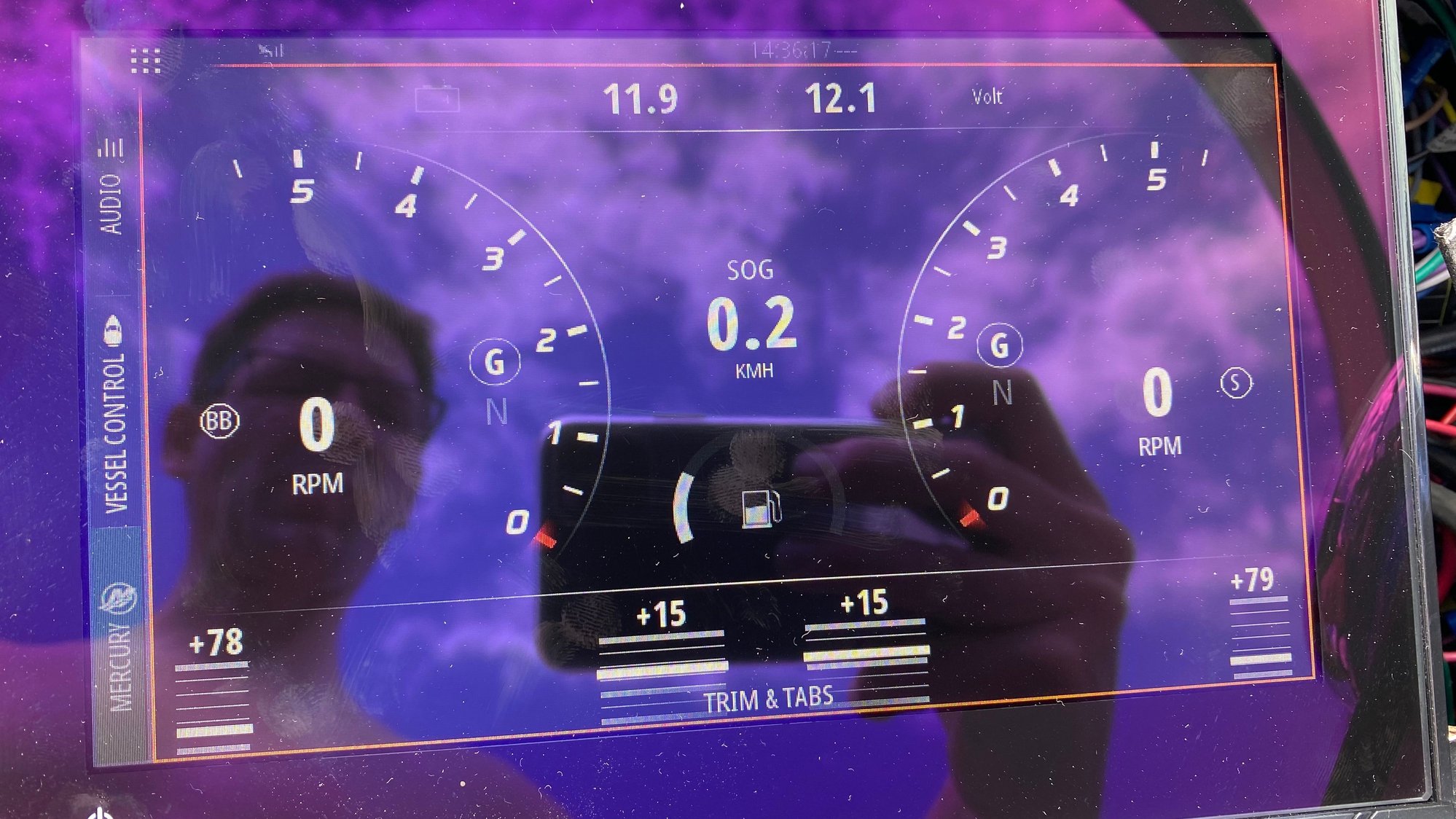

If smartcraft engines are installed use the GO9, it is same as VesselView903 from Mercruiser and now it uses the same Software. Fusion Audio Compatibel over thouch.

I like the simrad Go series for the smartcraft ability and I have it networked to my JL media master. I don’t really ever use the navigation on it.

Late to the show, but currently testings an Axiom 7. Give it about a 6 in the direct sunlight cranked to the max. The build in GPS, worthless if mounted under aluminum. Stereo control with Fusion works very nice. Has Spotify, Netflix and few other things you'll never use. Charting, all about the same software anymore.. Gauges, ah... Simrad be what ya want...
