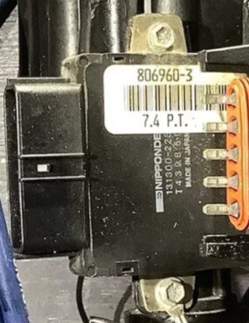

I have a thunderbolt V, 806960-3 electronic control module
what is the RPM cutoff, does anybody have the documentation for these modules?
what is P.T.??
what engine is the P.T. for?
bravo
mag
Alpha
Thanks for your help, any and all Info is welcome. I made a 454 gen V with about 9.5 compression, vortec Head large oval ports, 100cc chambers, flat top pistons, with 01-445-8 comp cams.

The Rev Limter for a 7.4 will kick in around 4750-4800rpms

Thanks Griff! I was hoping to get 5000+ rpm, was shooting for 5400, cam, intake, exhaust, head work.
I'll go with the thunderbolt IV v8 24 to find my max rpm after breaking it in. If it's around 4750, I will use the thunderbolt V, if it's around the 5000+ I'll have to stick with the thunderbolt IV.
I would still like to know what engine model the P.T. is. I did locate the wiring diagram.

A TB V module from a carbed HP500 rev limit would be 5400ish.
