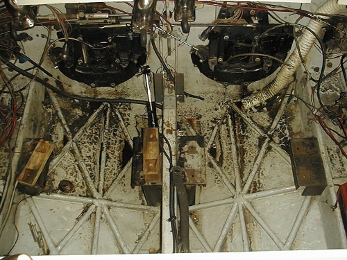

Here's a shot of my boat with the engines and transmissions removed. One bellows was full of oil, one bellows was full of water. Cracked gimbal flange and damaged external bell housing on one side. Wiring and plumbing were cobbled together. Mercruiser transmissions with burnt fluid.
