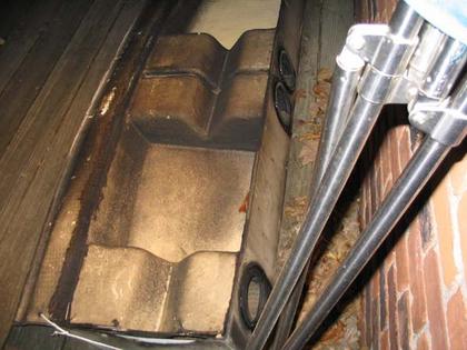

Here's what the inside will look like, assuming it's the same as the 95 336. Mine was split along the edge at the bottom of the pic and cracked in a couple of places. I took it off and never looked back. I'll try to fix it with 5200 and some small machine bolts if they decide to crack down on loud boats. Until then, she's staying loud and rattle free.

I had the same issue. Soot on the transom where I could see the exhaust was leaking past the platform. At the very bottom of the pic you can see a white crescent shaped spot. The seal between the exhaust chamber and outer shell was split there and that spot was rattleing and actually sanded a similar spot in the gelcoat on the boat. Took it off down to the fiberglass(I still need to fix that).
Anyway, to take it off I removed the ladder and the bolts off the back of the platform. It had some caulk that was holding it up, so I pulled down on it and it stayed there with a couple of inch gap at the back. I tied some clothesline to the outside bolt holes and secured it to the cleats up on he back to hold it while I took out the screws that held it to the transom brackets. Once those were off, I pulled it straight back. The gaskets around the exhaust will stick and the tips extend maybe an inch off the transom. Once it's clear of the adhesive gaskets and tips, it will come off and hang by the clothesline (I did that because I did it alone and wasn't sure how heavy it would be.) I'll guess it's weight to be 40-50#, more bulky than heavy. It would have been easier with a helper.
