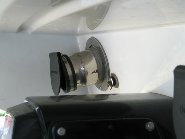

Hey guys, I have some nice 4" salisbury flappers for the through hull fittings will keep water from backing up the tailpipes. I went to GGB mufflers and 4 1/2" flappers, so if anyone can use these ...
Attached Thumbnails removing silent thunder boxes-382-007.jpg   removing silent thunder boxes-ocean-013.jpg
I put the same thing on the factory tips. Even though there is an internal flapper, I wanted the rubber ones like you have shown too.

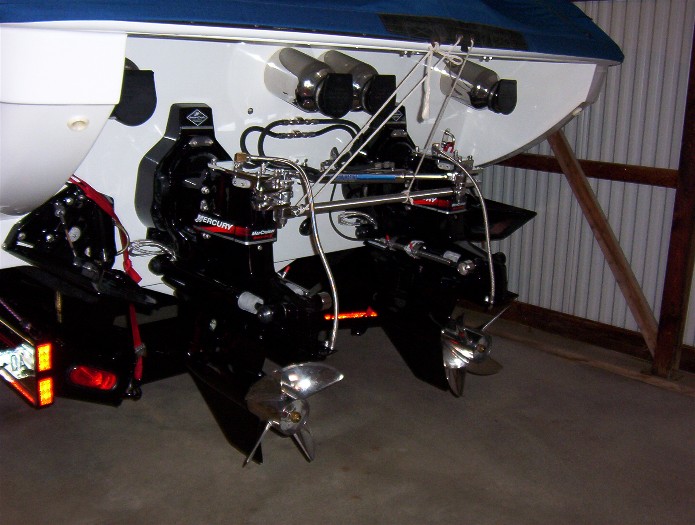

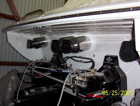

very rewarding project! It's cake, did the whole project by myself start to finish
Attached Thumbnails removing silent thunder boxes-ass.jpg   removing silent thunder boxes-corsas.jpg

Rippem-
That looks so much better! I am looking to do that to my 382 this weekend.
