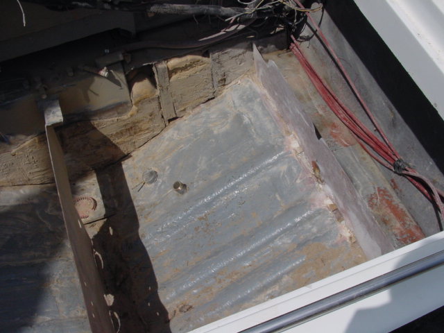

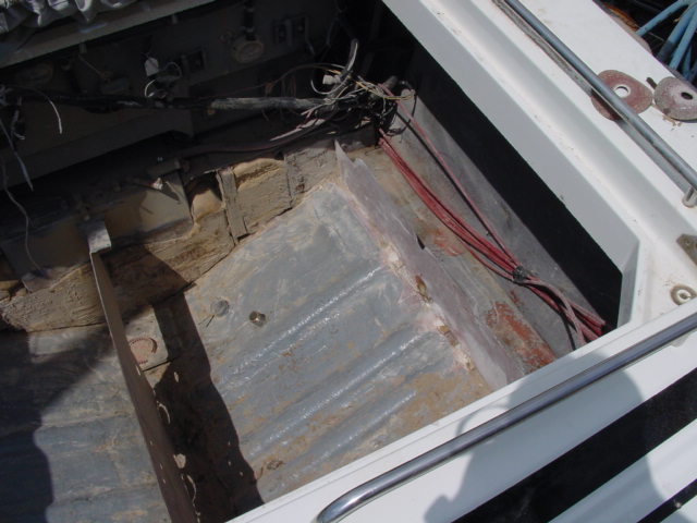

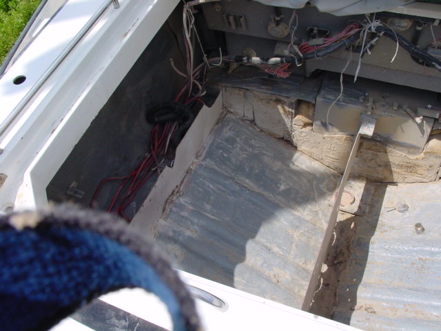

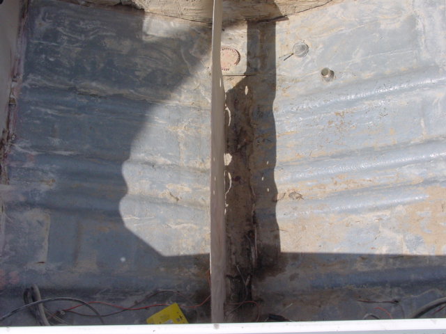

cut one side of each stringer out of the boat .... the cut outs will be used as patterns for the foam. Foam will be glassed on one side and then reinstalled in the boat and glassed into the existing stringers. The bulkhead will have to be completely built from scratch, there was nothing left. The old bulkhead was about 1" total but we are going to use the 1 1/2" foam which will result in about a 2" bulkhead .....we also are going to build supports from the outside stringers to the hull ....about 8" on each side of where the motor mounts are ....should be VERY strong ..
Attached Thumbnails project ......-dsc00031.jpg   project ......-dsc00032.jpg   project ......-dsc00033.jpg

pics
Attached Thumbnails project ......-dsc00034.jpg   project ......-dsc00035.jpg   project ......-dsc00036.jpg
