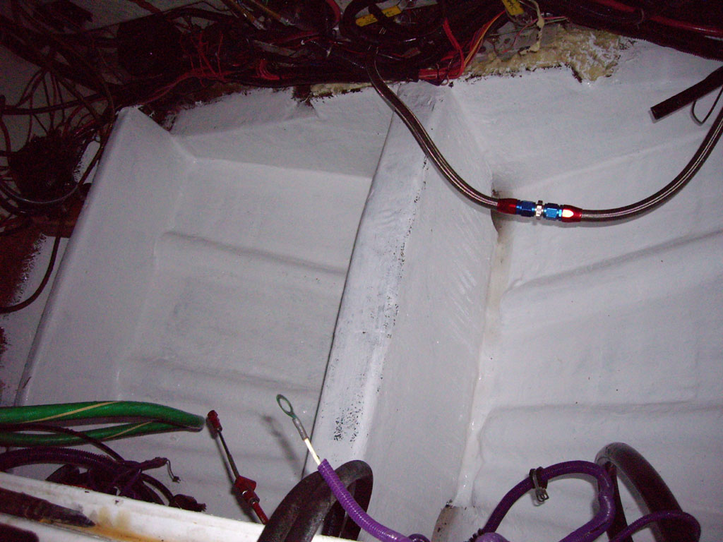

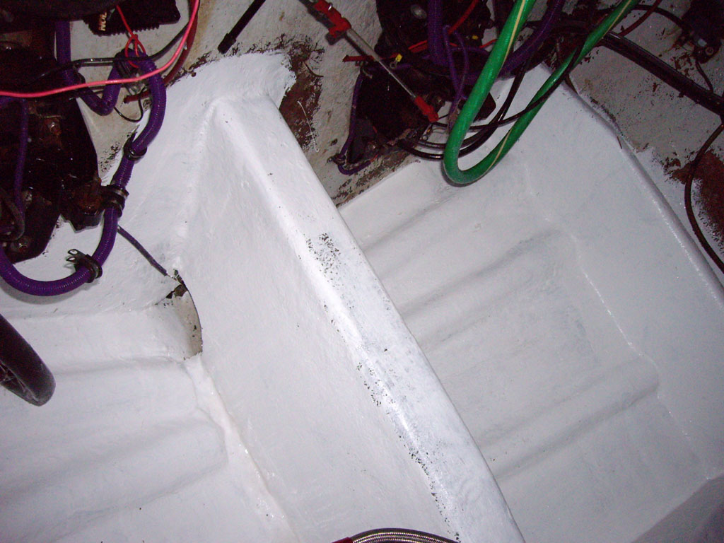

The bulkhead was the worst on mine but the real culprit on mine was the fiberglass that holds the center stringer to the hull had let go around the drain pipes that run the lenght of it on the right side. I did have some rot in the center stringer, guess it would have lasted for a while but didn't want to do this multiple times. Here are some photos with the bulkhead and outer stringers glassed in, the center stringer is was just being fitted.
You will notice that I didn't do the cutout for the bilge pump, I decided I will mount it to one side. Also I didn't do the channel under the center stringer and pipes on either side, I just cut the ridges back enought that water can flow down along the sides of the stringer.

This is what it looks like partially painted (ran out).
