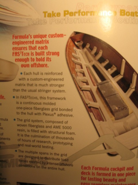

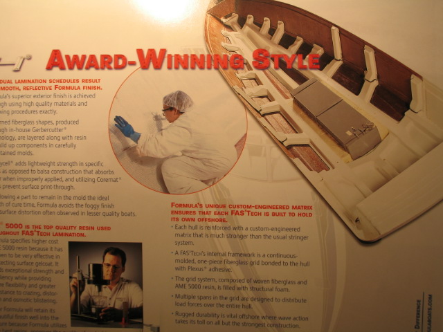

What exactly is an "integrated matrix system"? Sounds like a great big difference! No rot! But, I haven't heard any complaints about rot on Formula's (at least on the one's that are taken care of).
Look for the thread by Offthefront about his 311. Audiofin's thread on his 302. From the Formula brochures:
Attached Thumbnails Differences between the 357 and the 382-fastech-matrix-001.jpg   Differences between the 357 and the 382-fastech-matrix-002.jpg   Differences between the 357 and the 382-fastech-matrix-004.jpg
