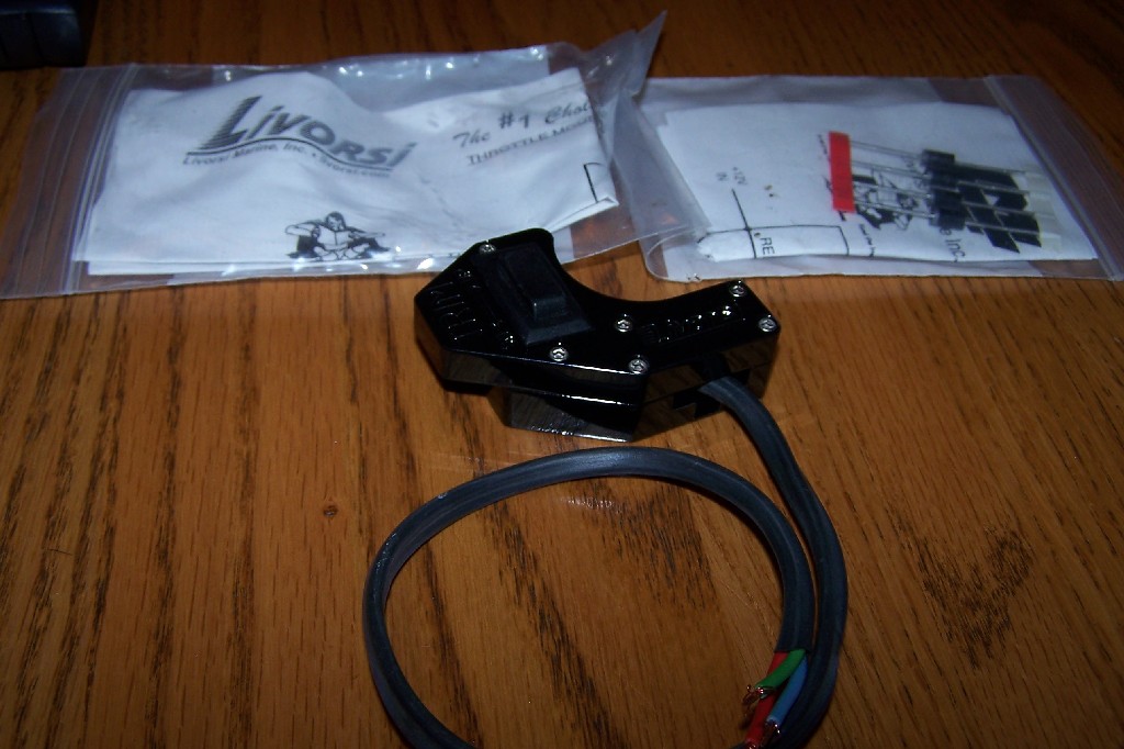

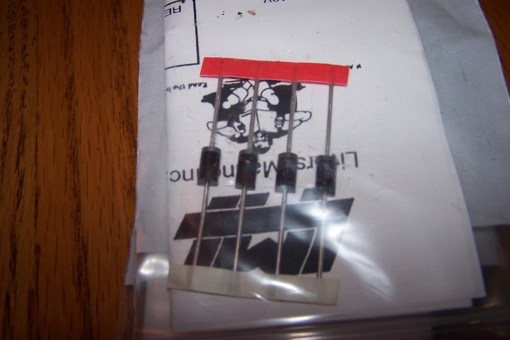

I have a new Livorsi add on control for twins with the diodes still in the package! Give you a great deal...PM me.
Dave

Livorsi PN#TRSBK...Lists for $96...Brand New and I'll take $80 shipped!
Dave

You can for sure do this. BUT the diodes are a must to prevent the juice from going places you don't want it going. Take a look at AXA's post on the switch he is offering, the bottom pic shows the diodes. You have to have them and they must be rated correctly for the application. Buy the package deal AXA has and get all the right stuff and save a buck at the same time.
