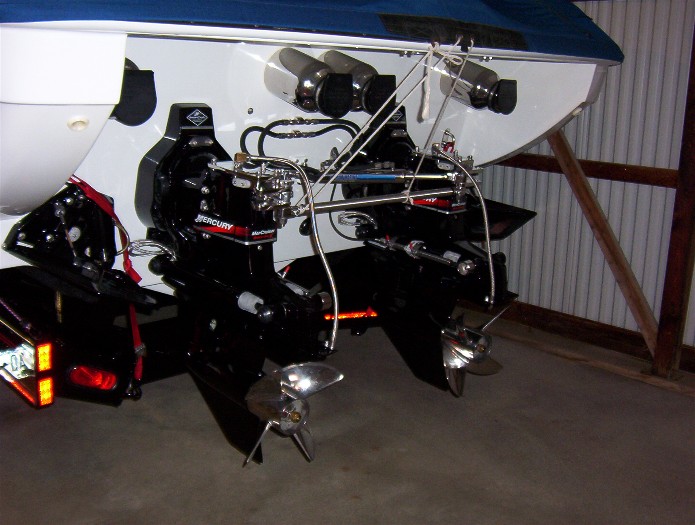

tell him to get rid of it and buy a pair of used Corsas or the like. They are plentiful as take-offs cheap/reasonable. No more box hassles, and that 271 could really benefit from the weight removal from the stern! Not to mention easier cleaning.
Hey Rip, how you doin'?
He's not gonna go for tips, wants it stock. Do you have an answer to my question seing how you removed yours totally?
