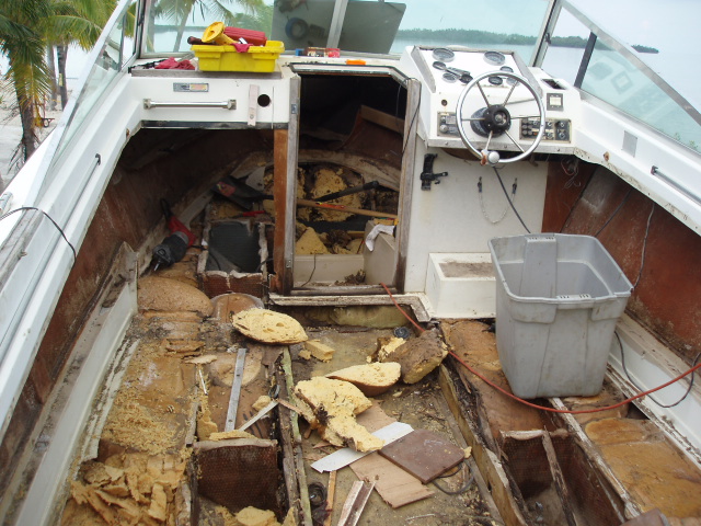

Enter 1980 formula 233 sportsman. It was given to me by a local marina here in Key West. Anything that was/is wood is infested with termites. also much of the foam has been chewed up into swisschees. They used the foam to create very intricte tunels. I've never seen anything like it before. So, Now Im gutting it completly. Im on day three of the demo. Here are some pictures of the boat, and I will follow with my next post with pics of the termites. I had to photograh it so I could share.

Check out the termites!!
The termites converted the foam into there lair. Very bizzare. Any of you ever seen something like this in a boat?
These pics are from fwd port just infront of the bulk head where the steering wheel is. Whever I'd sawzall a fiber peice, beneath it I found thousands of termite. The boat was like that from bow to stern. Amazing!!
The first picture is of what once was foam. They shreaded it and created these bizare termite homes.

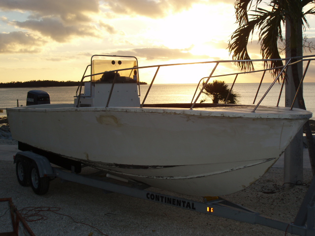

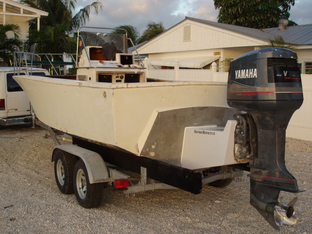

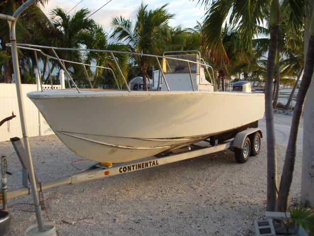

Its been a while since my last post, but that because I've been up to my ears in fiberglass!
So heres an update:
The boat was completly gutted, top removed. What a mess!
Reglassed and built new transom.. Repaired any damage and then put new stringers and bulkheads in. Raised the floor by 3 inches. (self bail)
Modified and re-cored the top. Its now set up like a center console. Instead of screwing it on I glued the two together then glassed inside. Tuff to do, but makes for a very solid setup.
Installed stainless marine bracket and purchased and installed 2000 yamaha 225.
Installed new bennete trim tabs M120's. New hydraulic steering. New fuel cell. Used center console from wellcraft.
You think the 225 will be enough to plane? What do you all think?? Inputs??
Its been a long hard road, but she's comming along nicely. My pop's is getting itchy to get fishing!
Here are some pictures:
So heres an update:
