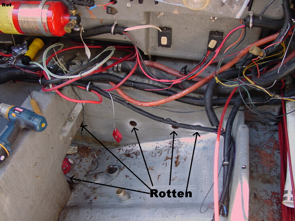

if you try to ad holes where the stringers meet the engine room bulkhead make sure its sealed from the inside ...drill it oversize then fill with west sytem epxy and then redrill ...if the plywood is exposed it will wick up water and rot the bulkhead and the stringer ...
I really think there is a path somwhere ... Is there not a drain in the center of the boat just before the bulkhead ? The 311 drains the cabin from there ...this is in the engine room...not forward .m
