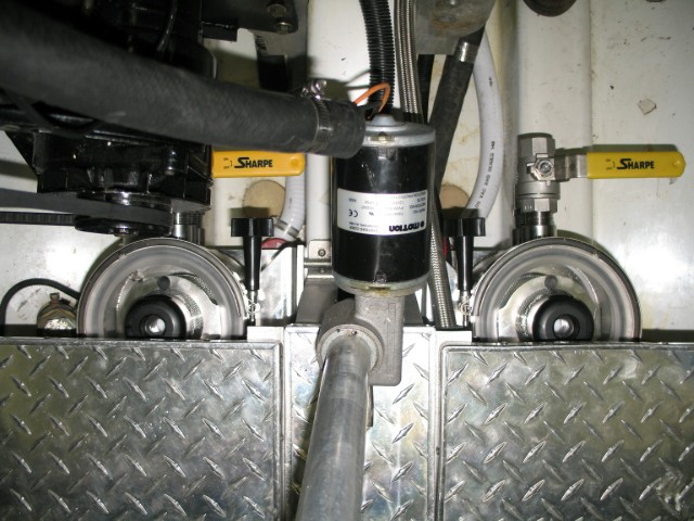

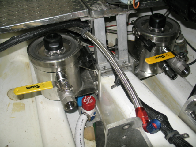

I just put the Stainless Marine in mine last season when the engines were out. Highly recommended by Steve from OSO. They are not cheap, but very good quality and fit perfectly. You may need to find another source ... I bought mine through Fred at Trick. He was more than fair to me on price and they were on time as promised, but who knows whats happening with Fred right now ...

Finished the plumbing before the start of the season. Flexible reinforced hose with straight fitting from the lower to the raw water pump intake, 45* fitting out of the top (shut-off valve) with reinforced flexible hose downward through the extension box to the drive fitting. Also fresh-water flush hose to 3rd fitting on the forward side of each strainer to hose connection.
