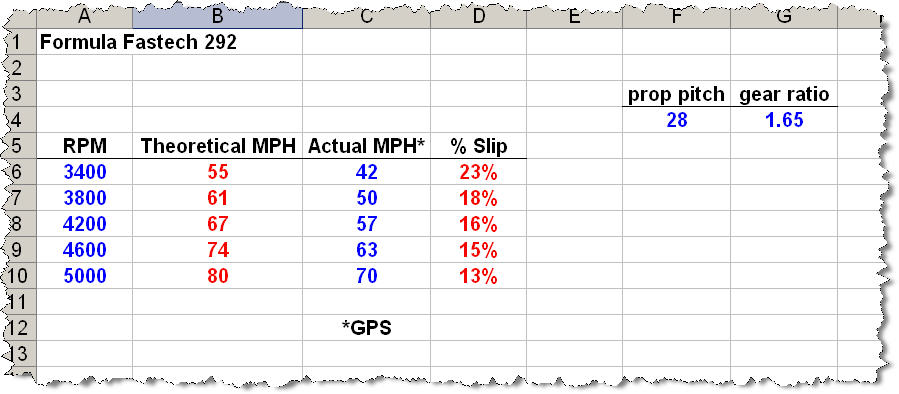

The 292 is only available with twin small blocks. Here's what mine runs with 6.2's (320 HP each). Fuel mileage averages 1.8 mpg at a 40-50 mph cruise.
