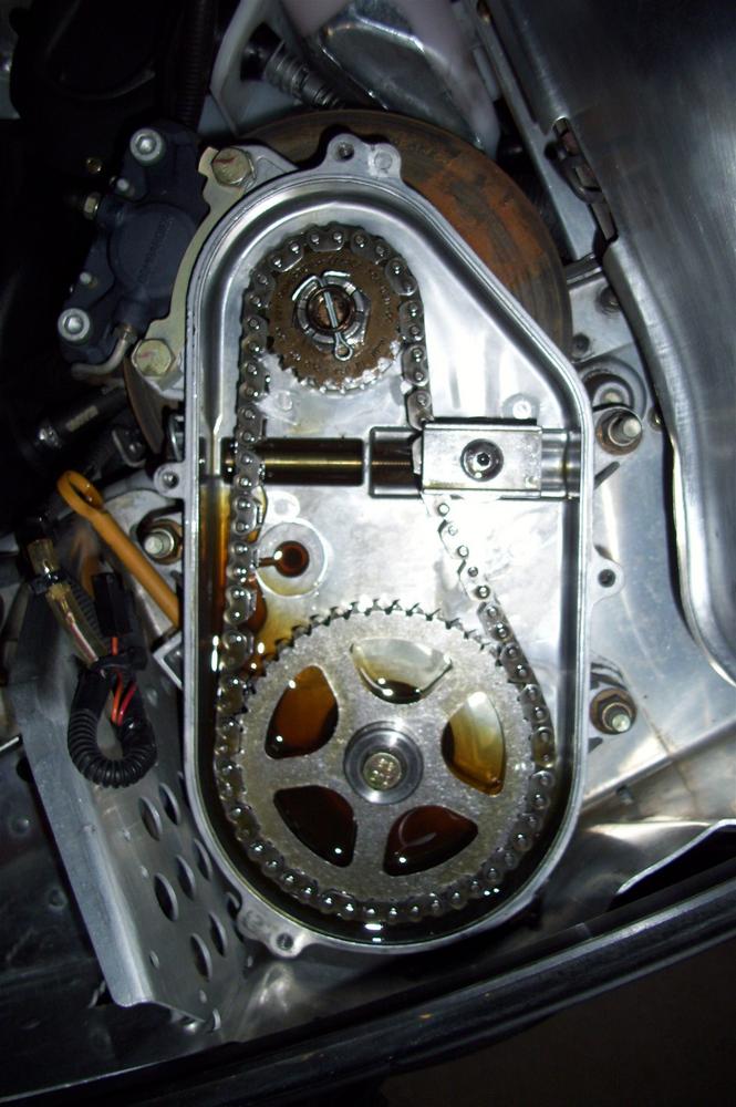

I've gone from a 1.95 drive ratio to 2.05
with a green 160/300 secondary spring and knocking my ramps down it feels good.
Doesn't stop pulling steady right at 8K with quicker acceleration and still a good backshift. Actually it feels like I have some "engine braking" effect off throttle which will make me smoother through the corners at higher speeds not having to use as much brake...
another effect of these changes is spending more higher speed running up in the OD dia. of the TRA.
This equates to as good or better high speed MPG and no top speed loss. It might even be a couple ticks faster because of the OD effect.
Gotta mark the clutches with a sharpie to know how far the belt is coming up in the primary at WOT
no rocket science here. Ski-Doos are typically undergeared from the factory and will pull more ratio. 'Ya just gotta "unlock" the additional performance that lurks.
I've run a similar program before many moons (9-10 years ago?) with my Mach Z. Pulled harder and picked up 5 on radar in trail trim from 106-111, with little other tuning. Of course there was 150+ 2 stroke triple HP to work with.
where there's only 108 HP here.

where there's only 108 HP here.Randy,
Your mods look great ..... now the question is can you ride ?
I like the 353 .... nice touch ..... just think if Pete were to have put something on the side of his sled it would say "Lightning McQueen" (from movie Cars) ....
Just kidd'in about the ride'in part ..... looking forward to Thursday ....
