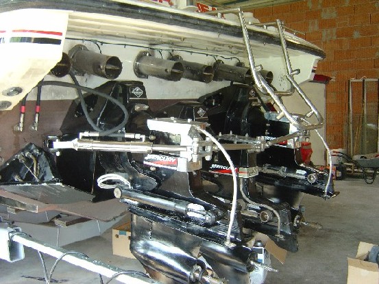

Default 419 Sr 1
419 SR 1 with Triple 496 HO
71 MPH running 1:50 Bravo 1 X drives and 26 `lab finished
Bravo One Props
Add Imco Extension boxes with 3 `rise and a Raylar BCK 103 kit 79 MPH running 30 `lab finished Bravo One Props
The old 419 SR 1 had an X Dimension disigned for Mirage Props - The boat likes the boxes with the 3 `rise
With the Raylar kit the boat plans on any two of three engines without a problem

nice set up!
