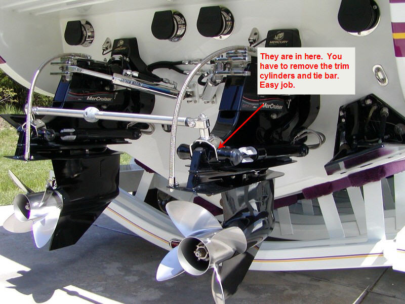

I looked but couldn't find the spacers, could you or someone post some pictures off what you need to do or a detailed instructions.

Here you go...

Just remove the plastic caps, tehn with a 5/8' open wrench, remove the lock nut on one side, then wiggle the threaded rod out to release the tir bar and trim cylinders. That will expose the spacers. then put back together. The most difficult part is alligning up the cylinders and tie bar to slide the threaded rod back through. When finished, do the other drive. Should take about 15 mintues to do both drives.
