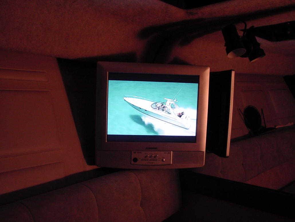

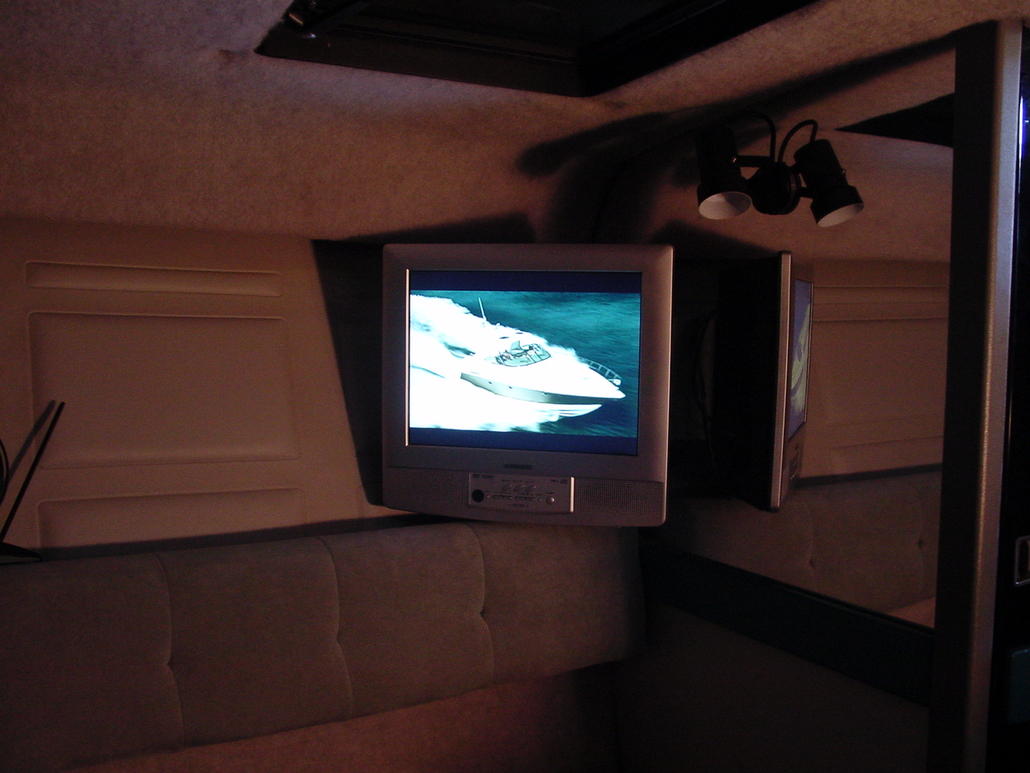

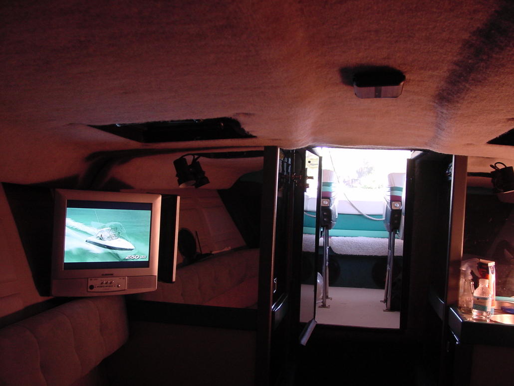

pics .....
Attached Thumbnails Dvd/tv-dsc00431.jpg   Dvd/tv-dsc00432.jpg   Dvd/tv-dsc00440.jpg

Thanks to everyone for the responses and pics. Mike, I like the way the tv is kind of tucked into the corner. Looks like it would make for a better viewing angle. What do your support brackets look like? I read your previous post, are they a loop type bracket or two "strips" of metal?
Exactly .....when there's a big crowd in the cabin and someone is on the far corner you can see the screen fine ..
It does work well though ..... If your faceing the Mirror the bracket goes from left to right about 6" ( this side bolts to the mirror) then comes straight out (90*) about 3" then 45's back toward the Starboard side about 7" ( LCD bolted to 7" side) .... Its Stainless about 1/8" thick ....very solid .....Sorry about the quality of the pics ...It was at night and the cover was on ..... If you need it I will get some better pics and exact measurements ......m
