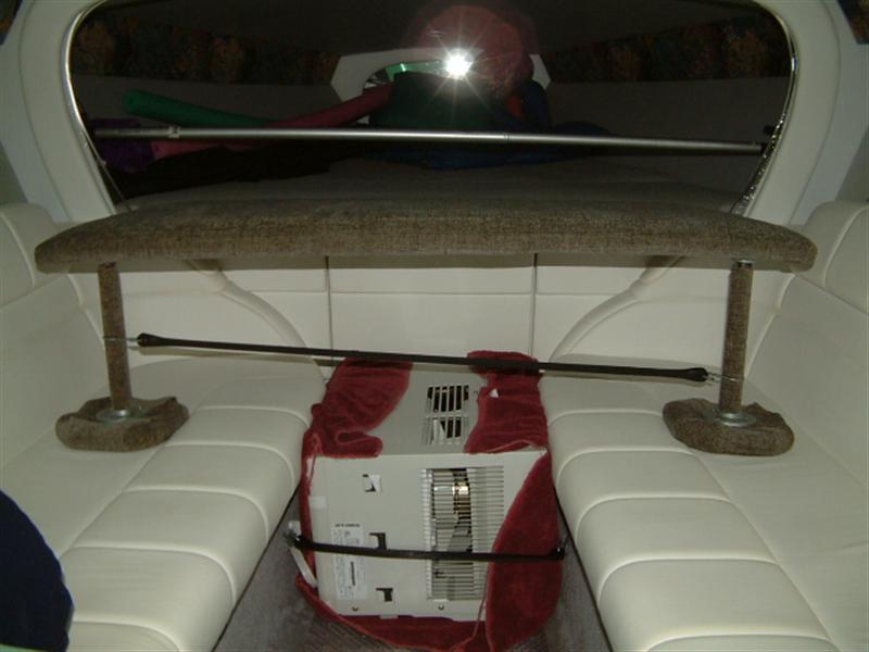

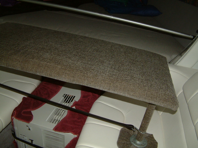

I built a 24in one in my 312 that worked great. I could move it up into the V-berth area when not used in about 30 seconds. Basically a padded/cloth covered board that had a lip and removable legs. We slept with out feet on it for 2 years until I sold the boat. I actually pushed all our clothes bags up into the point above our heads and we would slide down where the bed was wider.......pics on another computer so I'll have to post them tonight.

The legs and bases are metal pipe and screw in fittings. I padded the top and the bottom of the feet since they were going to be sitting on the couches. I made the legs a little long since our weight would sink them into the couches a little.

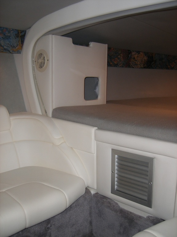

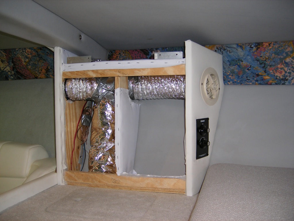

I added a pic of the AC cabinet I made too.......(we were using a home window unit in the doorway when the bed was first built).
Attached Thumbnails V-berth mod-early-bed-extension.jpg   V-berth mod-312-bed-extension.jpg   V-berth mod-312-bed-ac.jpg

all of the above.....I could sit on it if it wasn't too close to the ceiling. The back side had a lip that simply hooked on the edge where the factory cushions stopped. When I wasn't using it I could slide it up under the factory cushions and it only stuck out about 6 inches (that did make it hard to lay on if the extension was under the cushion but why would you need to do that anyway???)
