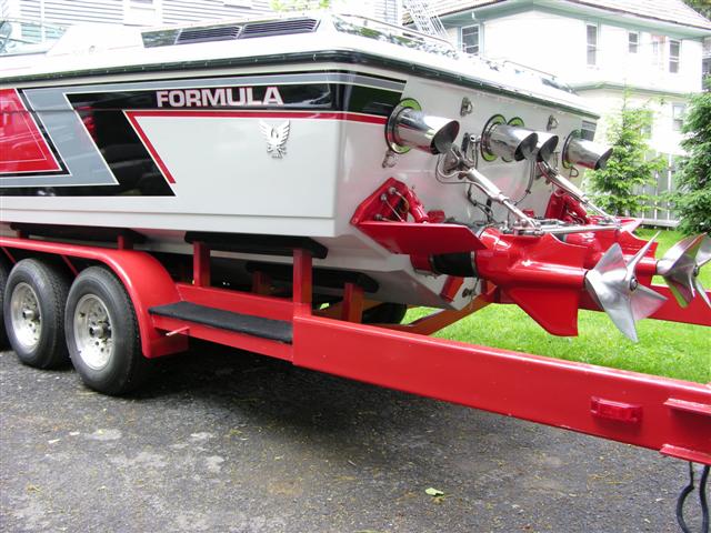

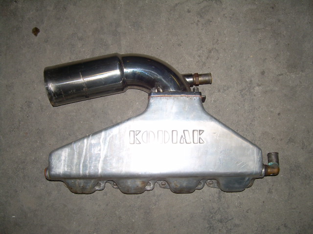

i have a setup from Kodiak with Imco ss risers that work fine. I know Lightnings will work. i don't see why KE wont? Stellings work as well. Here is a pic of mine.

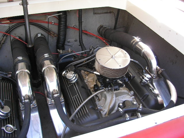

Here is a Stellings setup looks like BIG$$$$$$$$$$
hey jer were did you get that pic. bruce
Off your buddys 357 he had i have another one too
I thought I recognized that engine compartment. Bruce
