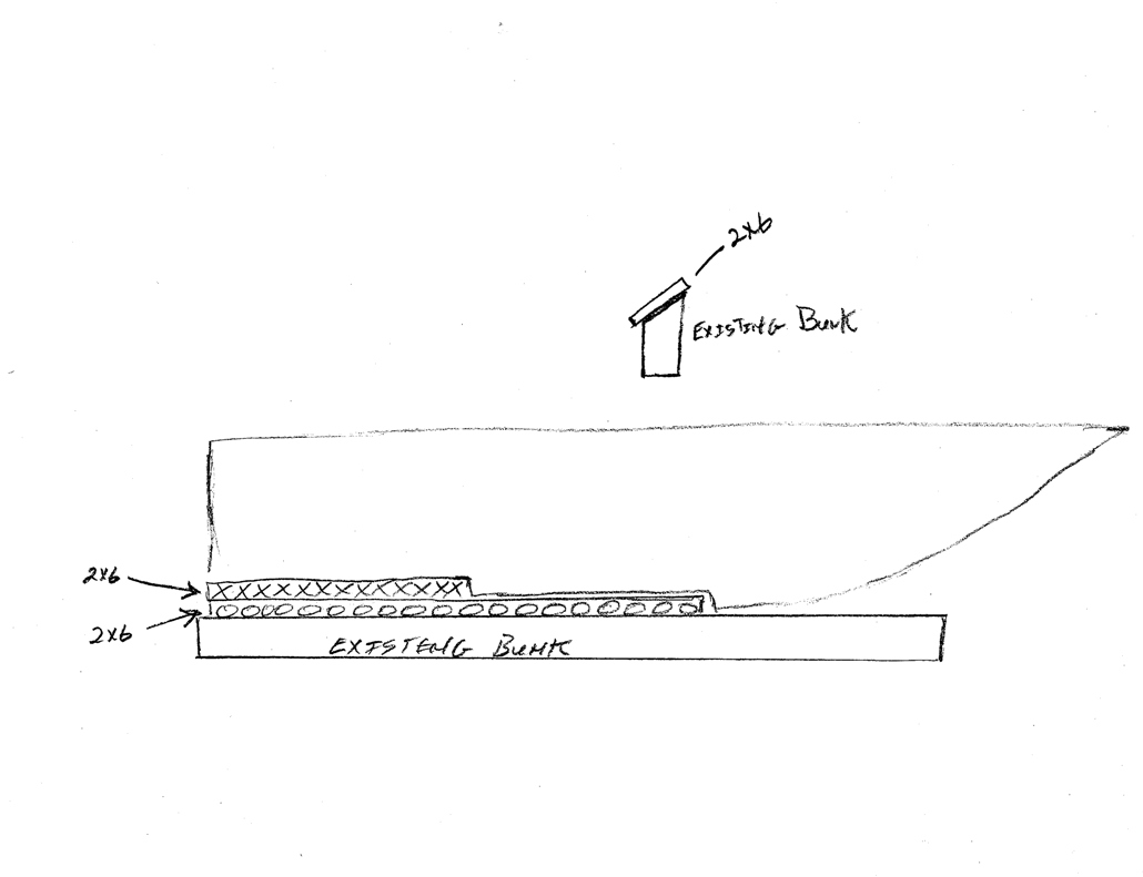

would the 2x6's sit right on top of the existing bunk or on the inside?

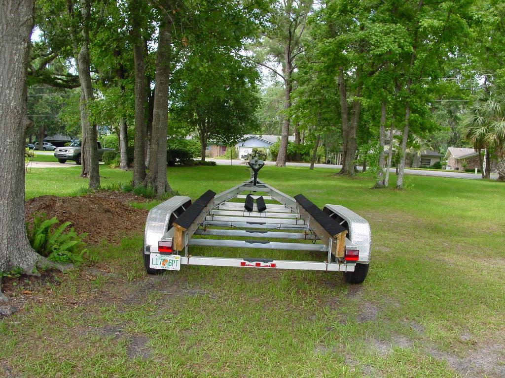

on top ....on the angle ....this is like I did for my 311 ....you could do the outside large bunks and the load the trailer and adjust the center bunks as needed .....

should i aim to support both steps or can i just do one...
i think i understand what your saying...cut an angle in the main bunk and attach the 2x6's to accommodate each step...hmmm
I would want both steps ...you dont have to get the entire lenght up to the step leave 6-8" before the step ...diagram now shows bunk cross section
