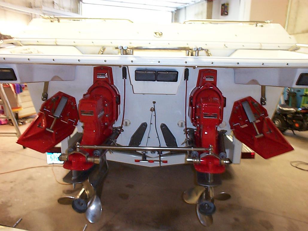

offthefront 09-02-2010 08:03 PM
1 Attachment(s)
you can shorten the bottom of the box on the Silent Thunder box ..... mopower had his box shortened
I have IMCO and they never hit unil I Raised the drives all the way (trailer) with the drives turned .... I did not shorten the box ....m
Jon ....... look at the right side of the center box and you will see a line (lip) in the Fiberglass ...you can cut the box there and then cut about 3-4" off and reattach the bottom .... Disreguard the text .... that pic was from a thread about keeping the platform and making the exhaust open like the Fastech ...
Audiofn 09-02-2010 09:25 PM
Thanks that may be what I will have to do. Looks like a bit of surgury

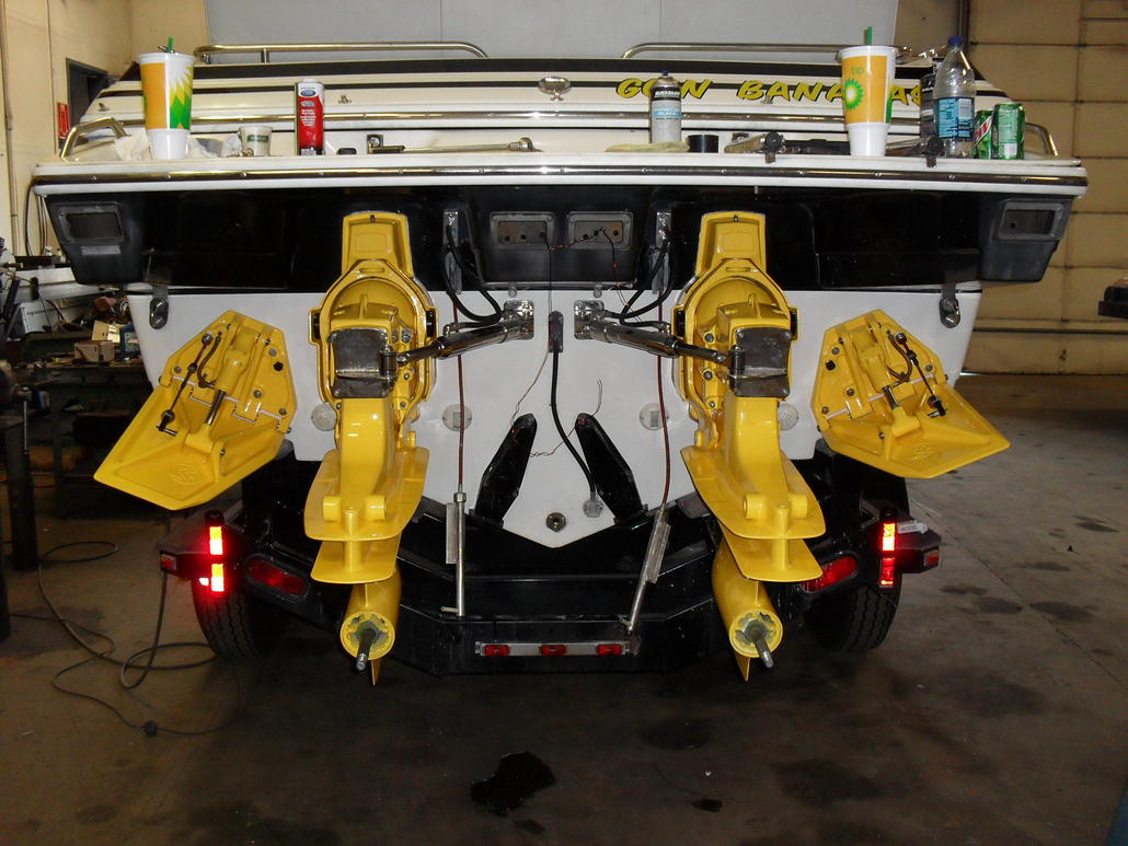

spazboz 09-03-2010 01:38 AM
2 Attachment(s)
Keep it internal like this, and you should be o'k. As stated in previous post, don't trim all the way TTT with your trailer trim.
Attachment 426199
Attachment 426200

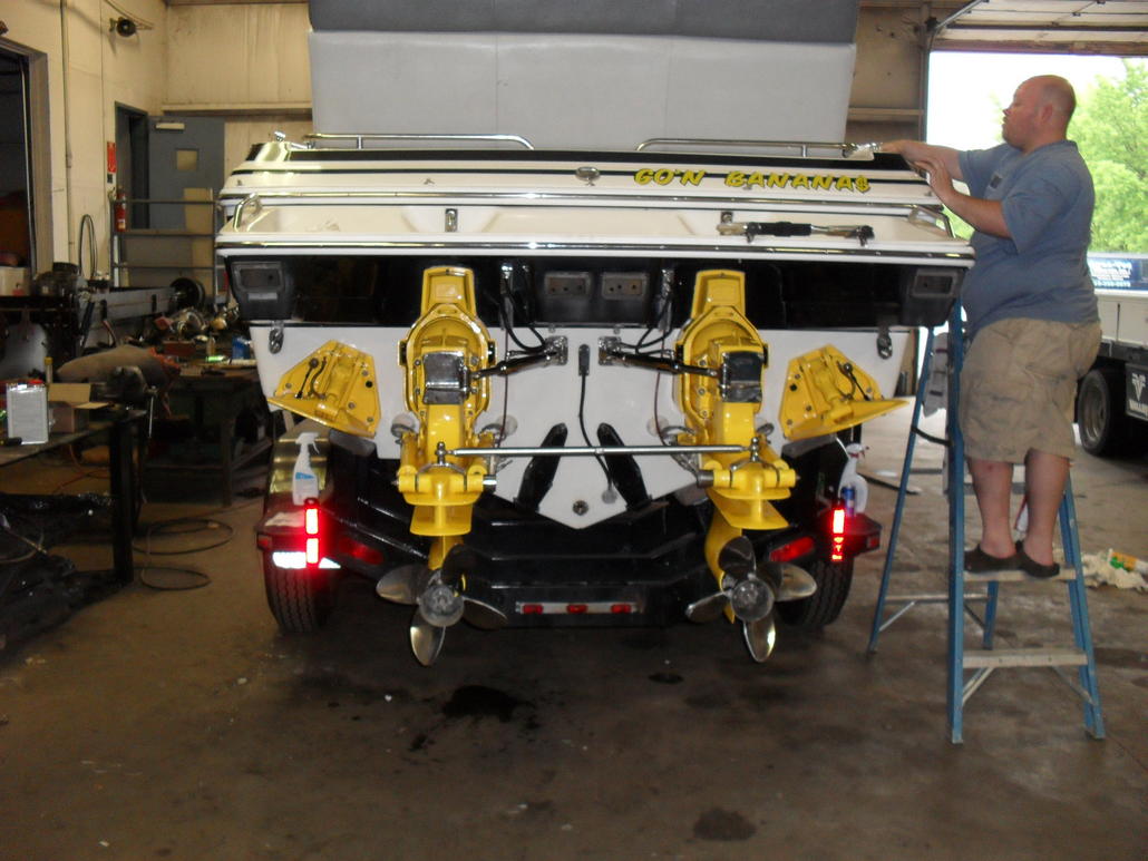

spazboz 09-03-2010 01:45 AM
1 Attachment(s)
I don't have as good of pictures of this project I did, but if you go external, you have to make notches like this to clear the rams.
Attachment 426201
