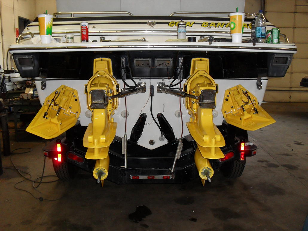

Keep it internal like this, and you should be o'k. As stated in previous post, don't trim all the way TTT with your trailer trim.
spazboz is offline

I don't have as good of pictures of this project I did, but if you go external, you have to make notches like this to clear the rams.
spazboz is offline
