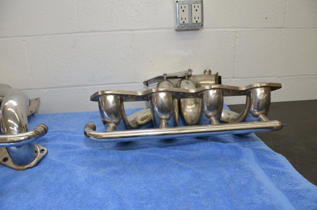

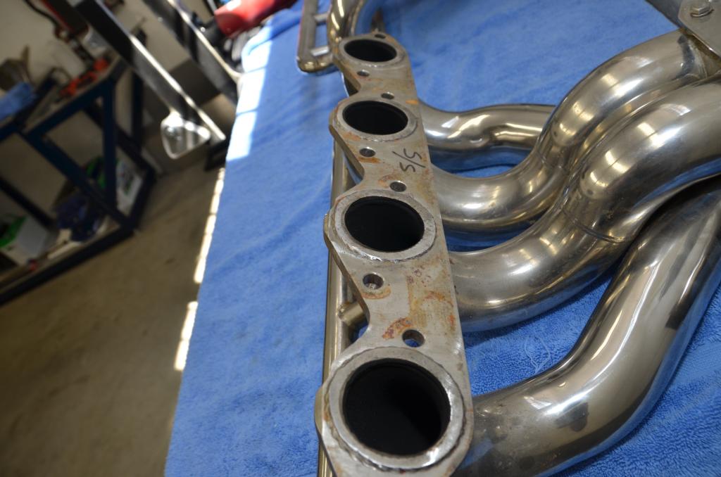

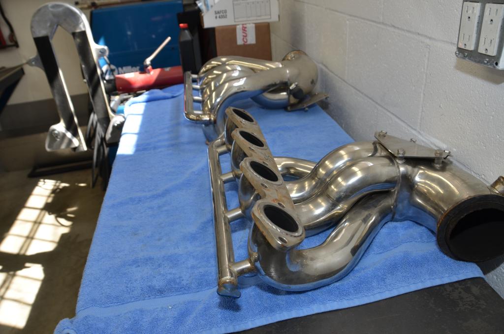

I figured they were 10 years old.....why risk the new engines with that? Someone came by the shop and offered $600 a pair for them as is. Sounds really nice to me!
Here are two of the old ones. I didn't even bother getting them tested or anything.

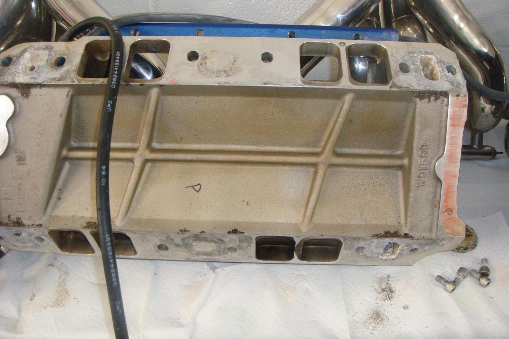

Oh.....those! So many parts. The Whipple intake manifolds are not plated at all. No matter what, they corrode. Also, the casting does not align with the gaskets they provide which also causes a water resriction. I had to machine the new ones and we also blue hard anodized the complete part. The new ones pictured here we sent back to them and got the non-painted ones so we could anodize the whole part.
