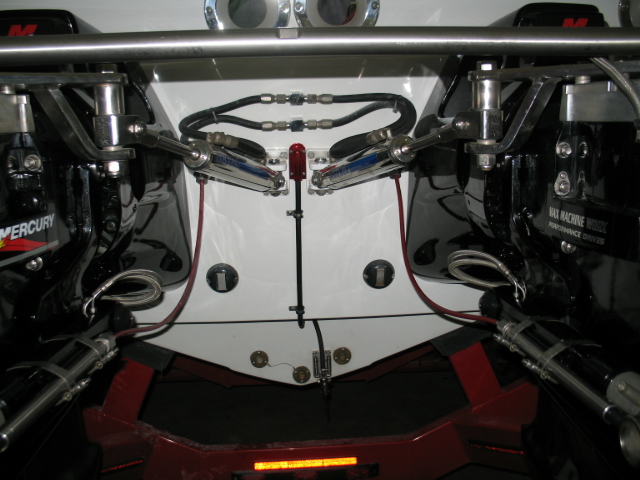

Mine has the same kind of damage that is in your first picture.
There is water in the laminations.
They said they will notch the transom from the inside,in a large perimeter around the cutout, but not cut right thru and install new wood and re-glass.
I had the exhaust thru hulls off in the summer when I installed
mufflers and that area was in good shape.

Mine is a 95 but you would think there would be some tech even in that distant past to seal transom cut outs and ventilate
the seat area.
The seat deal is not a big expense but the transom repairs can add up.
How did your guy rebuild the transom.

There was no need to rebuild it. The was no moisture in the transom, just some minor separation of the plywood layers around the edges of the cut-outs. The dark discoloration you see on the gelcoat in the "before" photo is grease that has splayed off the driveshaft spline of the Stellings boxes. Cutouts were stripped down to bare wood, rebonded, and then sealed with epoxy resin to prevent future water intrusion.
I was extremely fortunate to have discovered the separation before it became a serious problem only because in my typical obsessive nature, I had pulled the Stellings boxes off to refinish them the right way. Since I have owned it, the boat has always been trailered and kept in my personal humidity and temperature-controlled inside storage building and meticulously maintained with no expense spared.
Completed job:
