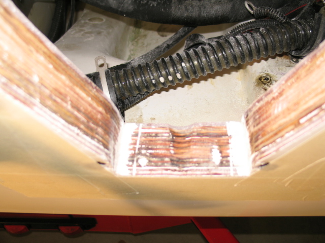

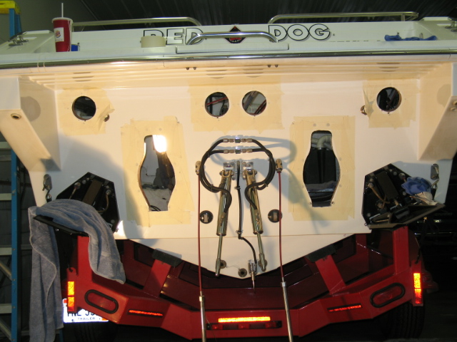

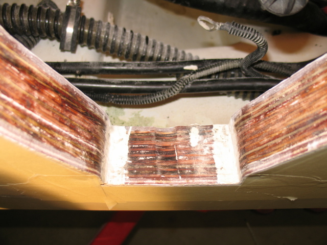

I did exactly that when I had the Stellings boxes off my 382 for refinishing a couple years ago. My fiberglass guy did a super job of sanding and sealing every hole in the transom including exhaust thru-hulls and transon assembly bolt holes with epoxy. As you can see in the photo, Formula does gelcoat the transom cutouts but that is not a fix-all. Note how we created a notch in the center to drain water away from the transom and back into the bilge.
Before and after:
